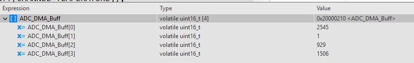

I use the STM32CubeIDE Version: 1.18.1 and the stm32g030k8.
I have a hardware that uses a firmware. This firmware correctly returns the values of the ADC. The ADC is linked to a DMA.
Channel 4 == 2545 (this is a voltage divisor) 12.5 volts
Channel 10 == 1 (this is connected to a current shunt resistor) No current, then almost 0.
Channel Temperature == 929
Channel Vreference == 1506

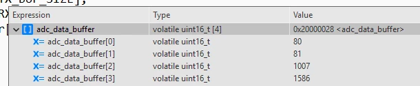

I develop a new firmware with the very same hardware (not just same design but same device). I apply debug optimization. I use ADC1 with the DMA, first I use the ioc file to set up the ADC and then I copy the MX_ADC1_Initfrom the other stm32cubeide project.
Yet It does not return the same value from the external pins. Why is that?
Thanks for all.
Best answer by carlesls2
Solved!
HAL_ADC_Start(&hadc1); and  HAL_ADCEx_Calibration_Start(&hadc1); were missing on the new firmware.
If the ADC is not callibrated it will return values like 82 and 83 instead of 0.

This is the configuration for the ADC in the former project and it works.

 * @brief This function's role is to connect the ADC to the DMA and to indicate the dedicated buffer to do it.
void MX_ADC1_Start(void){
 HAL_ADC_Start_DMA(&hadc1,(uint32_t *)ADC_DMA_Buff, ADC_CHANEL_NUMBER);
}// End MX_ADC1_Start

And this is the new project that is unable to write or produce a valid ADC value.

carlesls2
carlesls2AuthorBest answer
June 17, 2025
Solved!
