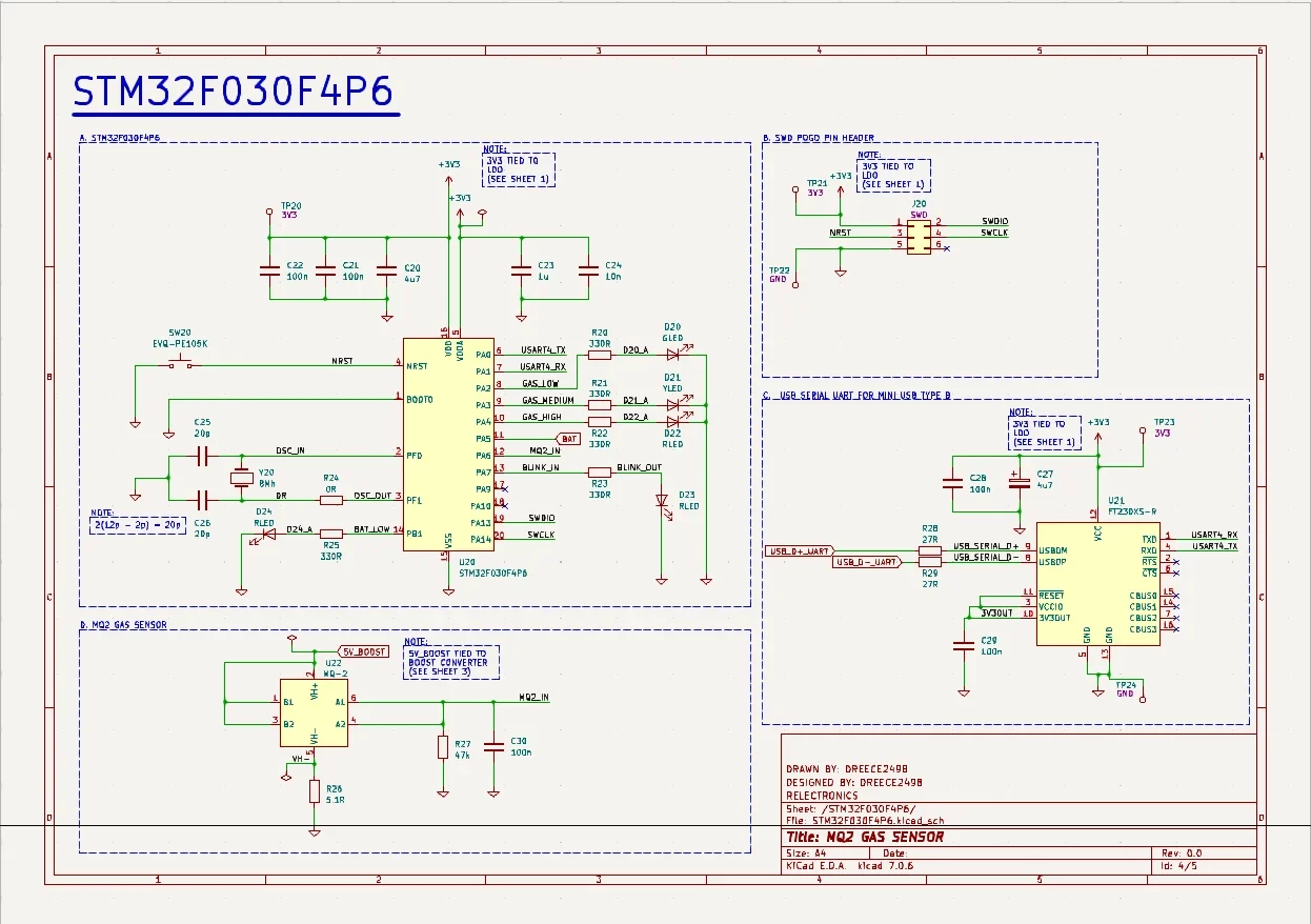

I recently have been working on a custom board with the stm32f030f4p6 for a gas sensor project, I just got it to bootload successfully and blink some LEDs so now I'm using the ADC channel to read values from it and converting it to a voltage level for testing sake (the final code will convert the values in ppm).
I've noticed almost a 30% error in the com port that I'm reading from an L476RG I have hooked up to via some external wires and I'm not exactly sure how to make it more accurate. For example, the current ADC voltage value I'm reading is 2.36 on PuTTY but on my multimeter, I only see 1.86 volts.

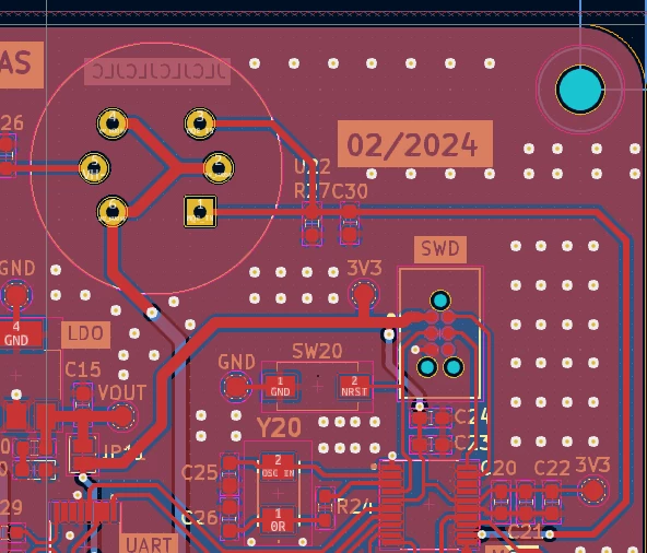

Here is a picture of the schematic:
And the layout:
The ADC is set to a 12-bit resolution and the sample size is at 1.5 cycles, I tried increasing the sample size but this didn't seem to do much.
Unfortunately, when I made this board I didn't realize I read the datasheet wrong and chose a UART IC when this MCU can only use USART, so I have no way of reading from the terminal without using the L476RGs ADC port and I feel using two MCUs for one setup also isn't helping.

waclawek.jan
May 24, 2024 9:30 PM UTC
>  Voltage = (ADCval *5.0) /(4095); //Obtains voltage value by taking ADC value from HAL, dividing it by the 16 bit resolution,
> //And multiplying it by the reference voltage of the STM32 (3.3V)
So, why do you multiply by 5.0?
Also, perform calibration before starting conversions.

waclawek.jan
May 25, 2024 9:37 AM UTC
> The 5V is the system voltage, as I'm powering the gas sensor from my DC to DC boost converter which outputs 5 volts.
No. The ADC does not care how do you power your gas sensor. ADC works out of its reference voltage, which comes from the VREF+ pin, which in your STM32 with small package is internally connected to VDDA,. which is at 3.3V according to your schematics.

Right now I have a wire soldered on from my gas sensor to a breadboard, with both grounds of the PCB and L476RG connected, and the analog pin from the L476RG connected after a resistor:
I know this isn't exactly the best way to do this, but I don't see any other way since there's no room on the pads of the MCU to solder a wire directly to it. I'm also assuming the cable length doesn't help.
waclawek.jan
May 27, 2024 12:34 PM UTC
Again, the ADC does not "know" about your 5V supply to the gas sensor.
The ADC works in that way that it outputs value which represents the ratio between input signal and the ADC reference voltage, which is connected to VREF+ pin of STM32 (in small packages VREF+ is connected internally to VDDA).
DRicc.2
DRicc.2Author
May 29, 2024 11:52 AM UTC
So I read the schematic of the L476RG, and you are correct it is connected to 3V3 as well. Its unsurprising since most MCUs operate at that voltage range anyway.
