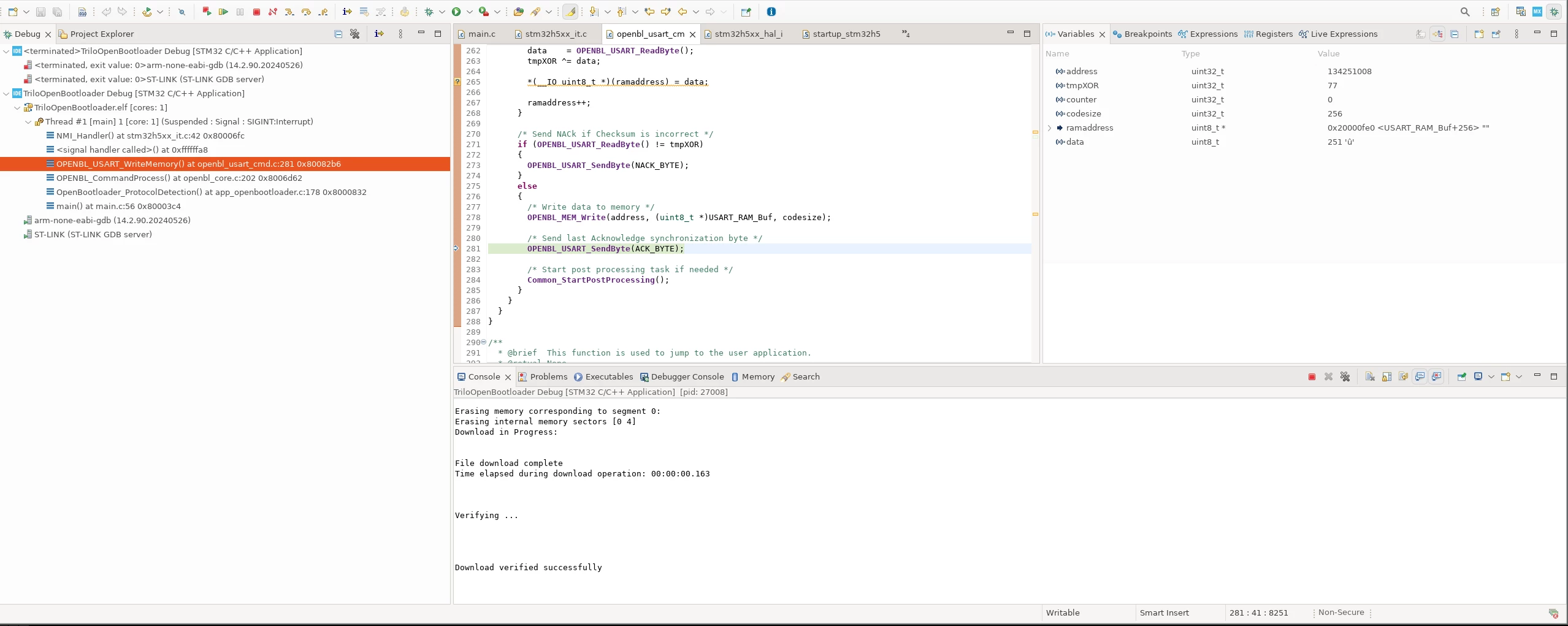

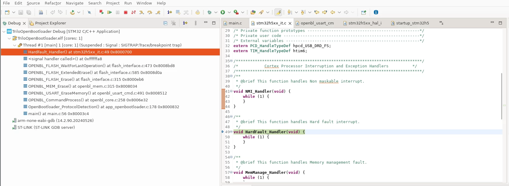

I noticed that I am getting an NMI_Handler() error called in OPENBL_USART_WriteMemory() if I try to upload with "Skip flash erase before programming".
If I don't skip flash erase, I get a hardfault (screenshots of stack traces of both attached)

It turns out that even though I was following the video tutorial series about OpenBootloader and they said it was fine to put the user app at this address, it turns out that the compiled size of OpenBootloader for me was greater than 32kb, and so I was actually erasing some of the bootloader when I tried to load the user app. After turning on size optimization and getting the bootloader within 32kb so that none of it was written beyond the 0x08008000 boundary, I was able to successfully upload and verify code.
I am still having an issue jumping to the user app however, and am getting a hard fault when setting the main stack pointer to the user app address.
