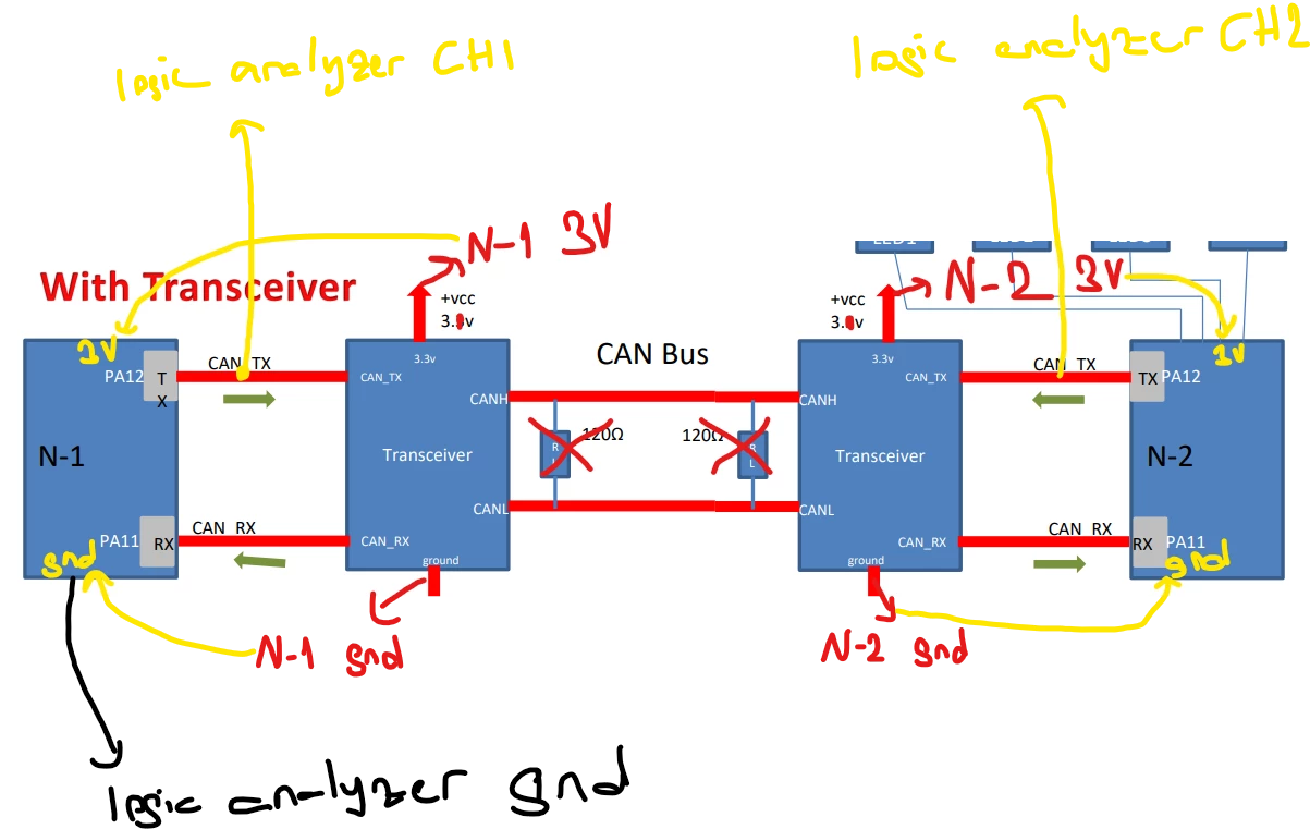

Hello there,
I am newbie in CAN communication. Although there is no problem in loopback mode, I get acknowledgment error in normal mode. For this reason, the tx message I sent continues to be sent because it was not ACKed, and after a while, all mailboxes fill up and the HAL_ADDTX function returns HAL_CAN_ERROR_PARAM. When I check the LEC register, I get Acknowledgment Error. I shared the diagram I used and my codes. You can review the main.c msp.c and it.c files on the Github link. The reason I don't use 120 ohms between CANH and CANL is because it's in my cjmcu230(with SN65HVD230) transciever module. I am using the same code on two STM32F429 boards. Thank you in advance for your help.
Github Link:
https://github.com/niekiran/MasteringMCU2/tree/master/Source_codes/OpenStm32SWB/MasteringMCU2/CAN_Normal_Mode_2Nodes
My Diagram:

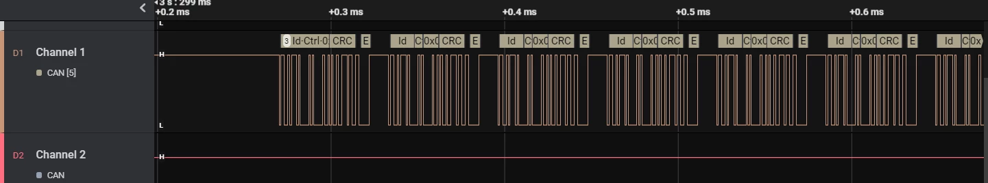

CANTx logic signals in my logic analyzer(you can see it keep repeats the same msg):

at first glance it looks like a hardware I assume with CAN:RX you mean the R output of the CAN Transceiver chips. Did you measure the RX-line coming from the N2 reveiver chip? It should be the same signal as the one you are sending out and viewing at CH1.
I assume there might be a disturbed outpu, Since you are operating the CAN trnasceivers at the very lower end of the allowed power supply.

The CH-1 signal is the CANTx signal found in N-1. The CH-2 signal is the CANTx signal in N-2. My purpose in these connections was to see that after the Tx signal I sent from N-1, the necessary ack signal came from the Tx signal in N-2. However, as you can see that the tx message is constantly repeated because the necessary ack signal does not come from N-2. And I also thought about the problem that might be caused by using 3V, but this is the maximum voltage I can get from the stm32f429 pins and I am afraid of that how can I increase it or if I increase it, I can disrupt the Rx Tx signals from PA11 and PA12. But right now I suspect most of my transcievers are corrupt.
