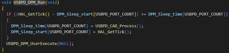

I am building a USBPD sink with reference to the UM2552, but in the sample code on page 16, it seems that the ")" corresponding to the IF on the 9th line has disappeared, is this a typo? Also, is there a correct example somewhere?

I have checked the package you gave me. It seems that the content is slightly different from UM2552, but is it this one?

Hi @Sodag.1​ ,
The USBPD_DPM_Run function differs depending on whether you are in RTOS or bare metal system.
In case of RTOS, the USBPD_DPM_Run function is used to start the OS and USBPD_DPM_UserExecute is the user application function called inside a dedicated task.
void USBPD_DPM_Run(void)
 OS_KERNEL_START();
In the case of bare metal, the USBPD_DPM_Run function is an infinite loop that calls the various entry points of the USBPD stack + USBPD_DPM_Users (for the user application)
 uint32_t port = 0;
 do
 USBPD_CAD_Process();
 for (port = 0; port < USBPD_PORT_COUNT; port++)
 if ((HAL_GetTick() - DPM_Sleep_start[port]) >= DPM_Sleep_time[port])
 DPM_Sleep_time[port] =
#ifdef _DRP
 USBPD_PE_StateMachine_DRP(port);
#elif _SRC
 USBPD_PE_StateMachine_SRC(port);
#elif _SNK
 USBPD_PE_StateMachine_SNK(port);
#endif /* _DRP */
 DPM_Sleep_start[port] = HAL_GetTick();
 USBPD_DPM_UserExecute(NULL);
 } while (1u == 1u);

thank you for your answer. I'm trying to build a USBPD on bare metal without RTOS. So I was trying to refer to the "do~while" of the USBPD_DPM_Run function
I'm trying to build a USBPD_SINK to pick up an arbitrary voltage. I think that the necessary description should be written in the USBPD_PE_StateMachine_SNK function in the USBPD_DPM_Run function function, but is it wrong?

Bare metal brings some constraints unlike RTOS we don't have preemption management. So you must avoid blocking the system inside a task. The main constraint is on the management of USB-PD message exchanges, the standard requires responding to a message within a maximum of 30ms. So user tasks must not block the scheduling for more than 28ms to have a margin.
in your case the function void USBPD_DPM_Run(void) manages the task schedule and USBPD_DPM_UserExecute can be used to call application code
yes a sink port must use USBPD_PE_StateMachine_SNK(port);
