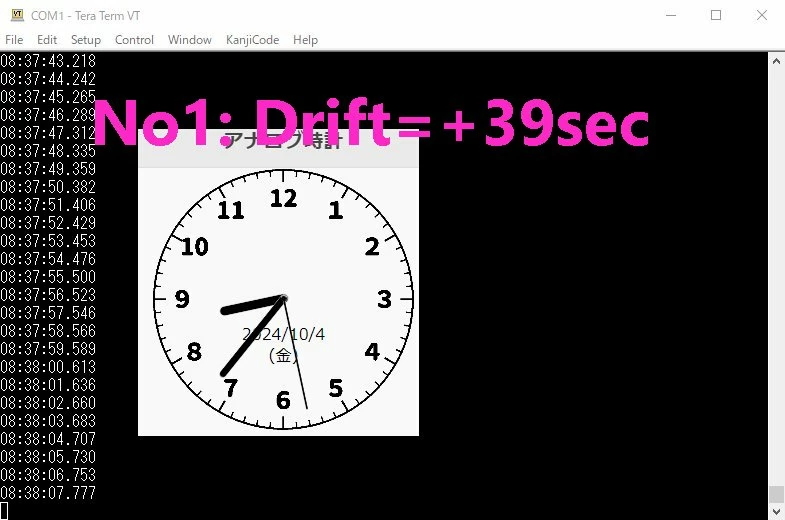

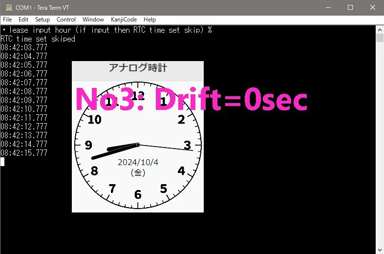

I set the time from a PC terminal using SimpleRTC. After setting, the time is displayed every second.
Meanwhile, I am displaying a clock page on the web on my PC and comparing the two. Since I set the RTC manually while looking at the clock page, I think the error in setting is 1 to 2 seconds at the most. I expect the error to be 2 to 3 seconds per hour.
I am attaching two images.
The first one shows the RTC clocks on board No. 3 matching.
The second one shows the RTC clock on board No. 1 39 seconds ahead.
Thank you in advance.

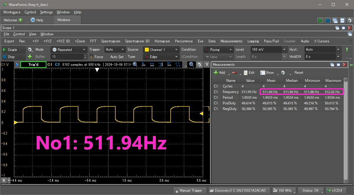

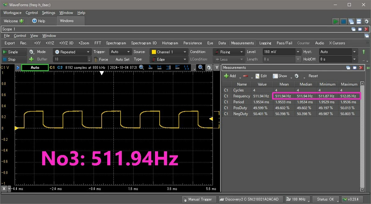

Also, since it can output 512Hz, I measured the average value with a USB oscilloscope, so I will attach two images. The frequency measurement was 1 minute and the trigger was rising. Both have little deviation.
The first is 512Hz for No.3, where the RTC works well.
The second is 512Hz for No.1, where the RTC advances by 30 seconds.
The delay seems to appear gradually as far as I can tell from the terminal. I'd like to find a way to check this, but I'm using delay(1000) in the loop function to display the time at 1 second intervals, so I don't understand whether subtracting the time from the terminal log will give me the correct 1 second error. Is this worth trying?
