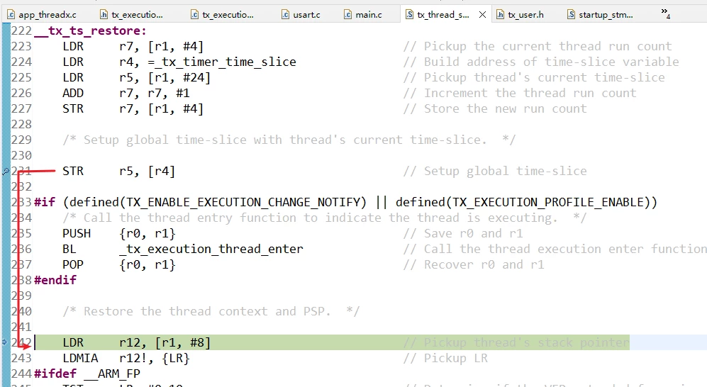

I debug the project and find that the problem is in tx_thread_schedule.S . It seems that the program did not run under this condition:
#if (defined(TX_ENABLE_EXECUTION_CHANGE_NOTIFY) || defined(TX_EXECUTION_PROFILE_ENABLE))
even if I already define TX_EXECUTION_PROFILE_ENABLE in tx_user.h. That makes me confused. because the .S includes tx_user.h .
However, I directly define TX_EXECUTION_PROFILE_ENABLE  in tx_thread_schedule.S . The problem is solved. But it's dangerous because the changes disappear when  I use stm32cubemx to regenerate the code.

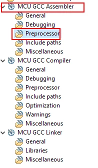

Haithem RahmaniBest answer
May 10, 2024 4:49 PM UTC
Hi  @xixi,
since the flag TX_EXECUTION_PROFILE_ENABLE is being used in ".S" you'll need to add that define in the assembly preporcessor rather than the C/C++ one.
regards
Haithem.

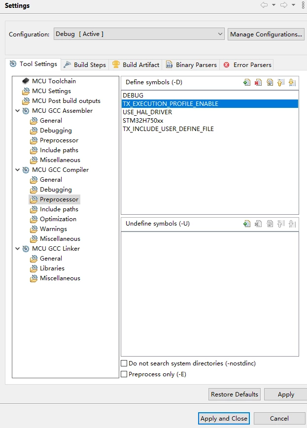

May 10, 2024 8:37 AM UTC
Hello @xixi, Welcome to ST Community,
Instead of defining TX_EXECUTION_PROFILE_ENABLE in tx_user.h, you can define it project-wide in STM32CubeIDE under C/C++ Build settings> processor sections> symbols, you have to re-apply that after regeneration.
This can be related to how the preprocessor handles include files in the compilation order, so, ensure that tx_user.h is included at the beginning of oftx_thread_schedule.S or any other relevant source files.
Also, ensure that the compiler's include paths are correctly set up in STM32CubeIDE so that tx_user.h can be found by the preprocessor when compiling tx_thread_schedule.S.

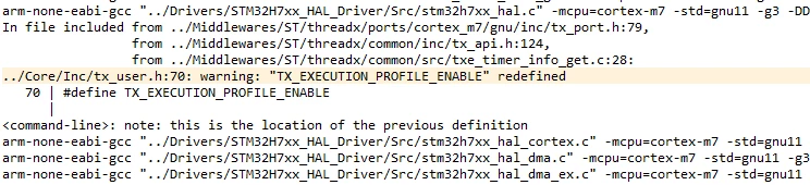

thank you for your reply. so quickly. I do as you said.
I notice the TX_EXECUTION_PROFILE_ENABLE is redefined when i build the project, because I don't delete the define in tx_user.h. but I decided to continue.
Unfortunately, the result is the same problem. tx_thread_schedule.S didn't run under
I don't know where I make a mistake. Sad...
Anyway, I don't change tx_thread_schedule.S . it was automatically generated by stm32cubemx. And the path of tx_user.h also was added by stm32cubemx. Maybe the problem comes from the setting about gcc or else. I don't know.
