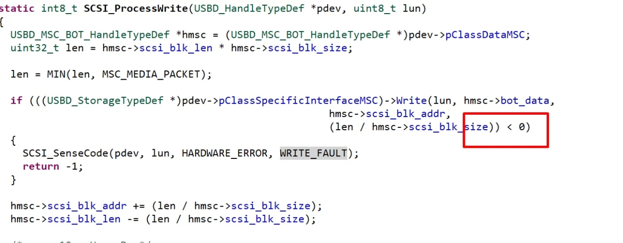

I have a serial FLASH, a part of which implements a Windows file system (removable block device). Another part of the FLASH is for data logging etc usage.
All this is working, but the ISR which implements the USB block device must be blocked out of the SPI function during data logging, obviously, otherwise it could jump in during one of the data logging accesses; the SPI and the FLASH are obviously not re-entrant!
I have tried disabling USB interrupts, via one of these methods
  • zeroing bit 0 of GAHBCFG
  • zeroing all of GINTMSK
and restoring these registers after SPI is finished. I am assuming they are fully readable...
Both methods work equally: 100% for protecting the data logging side but there is a tiny chance of USB accesses (file writes, 2MB files) getting corrupted; probability is around the PPM level but not zero, and only if there is heavy data logging FLASH usage. USB file reads are 100% reliable.
USB ints are potentially disabled for 1 FLASH page write which is 18ms. The Windows host is fine with that - so long as I delay about 10ms after each FLASH page write (during logging) to give USB a chance to get in. I also need a bit of a delay to avoid data corruption on the USB VCP which is used for debugs; not surprising.
Another method is for the data logging side to set a flag when using SPI, and when the USB ISR sees this, it returns USBD_BUSY (instead of USBD_OK) and stays out of the SPI. Same principle used in say a USB to serial converter, when the UART TX buffer is full.
This also works 100% for protecting the data logging side, but USB written files are heavily corrupted. I can't see why.
Can anyone see a reason for this? Are the two registers above not quite what they seem in the RM? The text says GAHBCFG should be set up just once and not touched, but the Cube IDE generated sample code does exactly the opposite!

There is a bug in the ST code in the higher-up driver. It fails to support any return code other than USBD_OK.
usbd_msc_scsi.c

Thanks for the tip about the NVIC, JW. However we are instead trying to do it "the proper way" which is returning a BUSY status.
To answer your question:
This is the usbd_storage_if.c generated by Cube for MSC that suggests the return code for the Write or Read functions should be USBD_OK or USBD_FAIL. The USBD error codes are positive values but the SCSI_ProcessWrite() in usbd_msc_scsi.c only tests for negative return values and consequently will ignore any error. This is surely a bug!
Even the very latest ST code has the same bug.
So that's some code generated by CubeMX? How does that suggestion look like? I don't use CubeIDE/CubeMX.
As far as I can tell, the example projects in Cube clearly indicate that 0 is OK and -1 is fail, e.g. here https://github.com/STMicroelectronics/STM32CubeF4/blob/4aba24d78fef03d797a82b258f37dbc84728bbb5/Projects/STM324xG_EVAL/Applications/USB_Device/MSC_Standalone/Src/usbd_storage.c#L169

I could not get the USBD_BUSY method to work. It almost looks like the USB host (a win7-64 machine) doesn't like to see a BUSY for 20ms (the FLASH write time). USB is just very unreliable. Same method has worked on other systems e.g. Atmel.
So I went back to disabling interrupts and currently I am achieving 100% reliability using the bit 0 of GAHBCFG method.
I started looking at the NVIC and after an hour of reading the RM gave up. I would need to read the current value, disable the USB global interrupt, and then restore the current value. I found macros in the ST code for enabling or disabling the interrupt in the NVIC and they are obvious enough but could not be sure re the code for reading the current setting first. I am OK with a delay of a number of instructions so this was not worth pursuing.
The BUSY method should work because disabling interrupts is a right bodge : - ) I am sure many have been down this road before and just silently fixed it.
