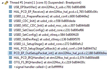

 * @brief Data received over USB OUT endpoint are sent over CDC interface
 * through this function.
 * We get here when there is some OUT data (OUT = PC to target). That data is
 * loaded into cdc_receive_temp_buffer[64], supplied to us here as "buf".
 * This is the call flow: https://peter-ftp.co.uk/screenshots/202209065715674317.jpg
 * Data is then copied into our circular buffer cdc_receive_buffer[1024].
 * No more data can be sent by PC until USBD_CDC_ReceivePacket gets called.

The last line above, USBD_CDC_ReceivePacket, is supposed to enable the next 1-64 byte packet to arrive from the PC. This is executed regardless of whether that circular buffer overflowed, which is not ideal because there is no flow control, but if I don't call USBD_CDC_ReceivePacket I need to call it later when the target application has extracted some data, but this is a difficult problem because with no data arriving that interrupt won't be happening. So I would need to call it from some foreground code, but then I have reentrancy issues.
The obvious way is to skip the USBD_CDC_ReceivePacket if that buffer is full and call it from the code which is extracting data from that circular buffer, whenever >=64 bytes of room is in there.

The flow control is very simple. When the device is not ready to receive the OUT data, it NAKs the OUT token, as usual. The controller should do this automatically, without any overhead on the firmware side.
When you call USBD_CDC_ReceivePacket you tell the controller to enable receive and get the following OUT data. Until you are ready to digest more data, don't call USBD_CDC_ReceivePacket.

OK, but that whole thing is called from an ISR which is generated by USB.
So if, upon finding the destination unable to consume more data, I don't call USBD_CDC_ReceivePacket, I don't get another chance to call it. No more data will ever arrive.
Or is that wrong... will USB keep repeating that interrupt?
My tests suggest that it does not. The moment that ISR executes without USBD_CDC_ReceivePacket being called, that is the end. No more USB data.
