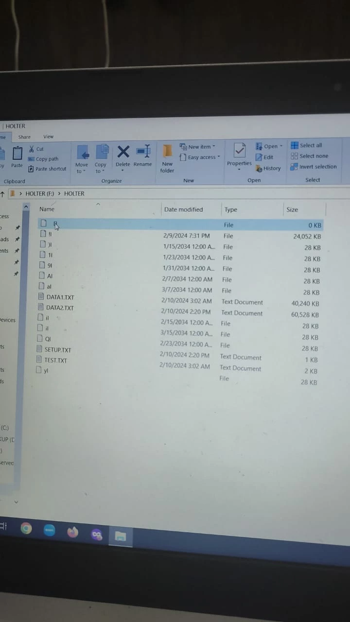

KPras.2
KPras.2Author
Feb 12, 2024 9:29 AM UTC
Dear ST community member,
Very good afternoon to all.
PFA image file name "Issue file created in the SD card" of the created weired file in sd card.
What will be the reason of these weired file creation??
In attache image - DATA1.TXT and DATA2.TXT, SETUP.TXT and TEST.TXT files are created by me.
DATA2.TXT created as per required and it is ok. DATA1.TXT file should be 64292KB but its size is only 40240KB with name DATA1.TXT and its rest of the file size (24052KB) created by the name - "!|" and its size is the rest of DATA1.TXT size. If we combine 40240KB and 24052KB the its size will be 64292KB. File size 40240KB is not corrupted and it will be open. But file size 24052KB is corrupted.
What will be the reason of this issue??
Please reply to us ASAP.
Regards
Kameshwar Prasad
Tesla DeLorean
Guru
Feb 12, 2024 10:48 AM UTC
Would make sure to use a current version. of FATFS and that the DISKIO layer is throughly tested.
Do not ignore errors reported
Output diagnostic and telemetry data so you can understand and identify the source of the failure.
