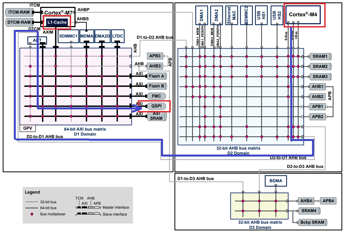

I'm working on QSPI FLASH in STM32H747I DISCO ,i was able to access XIP mode in M7 .
Currently I'm trying to work on M4 tried XIP mode in CM4 but there isn't cache in M4 ,and i was not able to access XIP mode .Is the cache the issue or something else.
The bus architecture doesn't have direct connection between CM4 and Cache memory .Please let me know what might be the issue .

There is no relation between cache and QuadSPI XIP mode.
Cache is part of cortex M7. No Cache from CM4 side but ART accelerator:
The line I drawn in purple is the path of CM4 access to QSPI through different stages including ART. So no Cache in the path.

How do i access the ART ??
mƎALLEm
February 2, 2024
Add this lines at the start:
 __HAL_RCC_ART_CLK_ENABLE(); /* Enable the Cortex-M4 ART Clock */
 __HAL_ART_CONFIG_BASE_ADDRESS(0x90000000UL); /* Configure the Cortex-M4 ART Base address to the QSPI */
 __HAL_ART_ENABLE(); /* Enable the Cortex-M4 ART */
Note that the accelerator covers only 1Mbyte from the start address.
