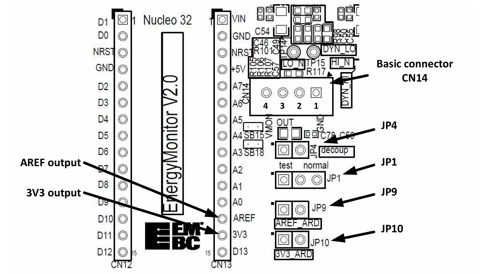

It should work fine. What pins are you using? Should be using pins 1 and 3 of CN14. Perhaps show a picture of your setup.

Yes, as specified in the user manual, I’m using pin 1 (GND) and pin 3 (VOUT) of CN14 on the X-NUCLEO-LPM01A board.

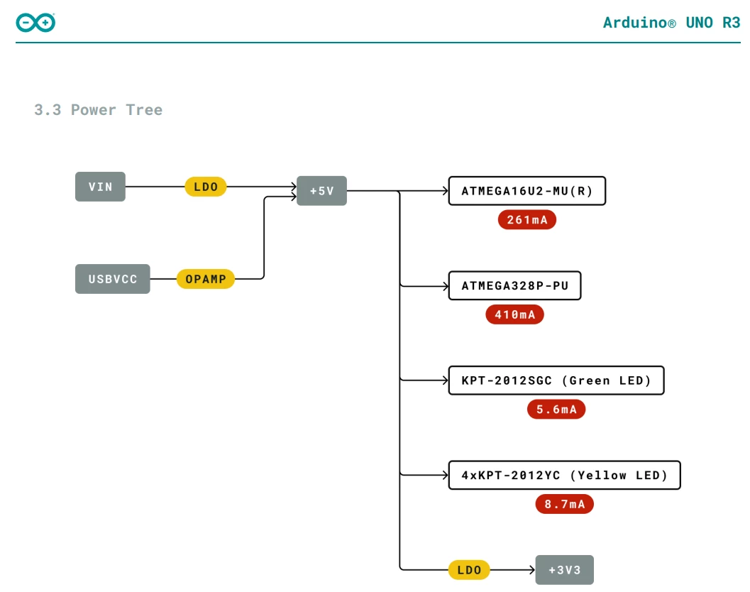

@Uday wrote:
Is it not recommended to supply power directly to the Arduino UNO's 3.3V pin using LPM01A?
Surely, that pin is an output - not an input?
What happens if you try to apply 3.3V to that pin from a standard power supply, and measure it with a standard meter - does that work?
PS:
Also, the Arduino UNO is a 5V system - it's not designed to run on 3.3V.
Is it an Arduino UNO R3? or R4? or what??
R3 Schematic: https://content.arduino.cc/assets/UNO-TH_Rev3e_sch.pdf
R4 Schematic: https://docs.arduino.cc/resources/schematics/ABX00080-schematics.pdf
@Uday  Indeed it is - as the User Manual shows:
https://docs.arduino.cc/resources/datasheets/A000066-datasheet.pdf#page=8
If you just apply power to the 3V3 pin, you are just driving the output of the LDO - so there is no power to the MCU or the rest of the system!

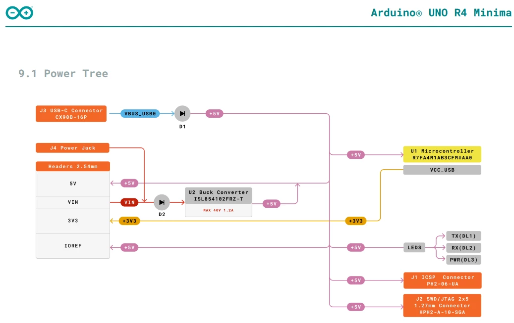

PS:
Similarly for the R4:
https://docs.arduino.cc/resources/datasheets/ABX00080-datasheet.pdf#page=12
