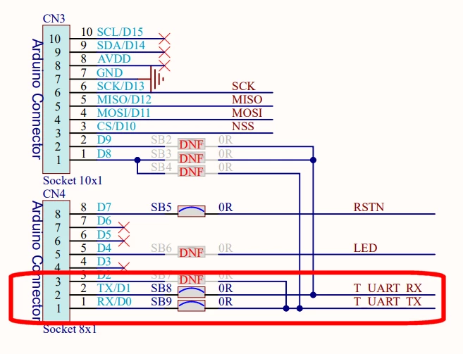

I am trying to make both IKS4A1 and WB05KN1 (see datasheet attached) shields work together on a NUCLEO-U575ZI.
Using the example projects I can use both separately. I used the SensorDemo_BLESensor-App from X-CUBE-WB05N (https://www.st.com/en/embedded-software/x-cube-wb05n.html) with the WB05KN1 and DataLogTerminal from X-CUBE-MEMS1 (https://www.st.com/en/embedded-software/x-cube-mems1.html).
I then try to plug both shields on the Nucleo board. I mounted the WB05KN1 on top of the IKS4A1. My first step was just to flash the board with the SensorDemo_BLESensor-App to see if it was still working. Unfortunately it is not.
I spend several hours trying to find the issue. I suspect a pin conflict but reading the documentations, I was not able to find the problem.I also notice that in this configuration the DataLogTerminal project is working.

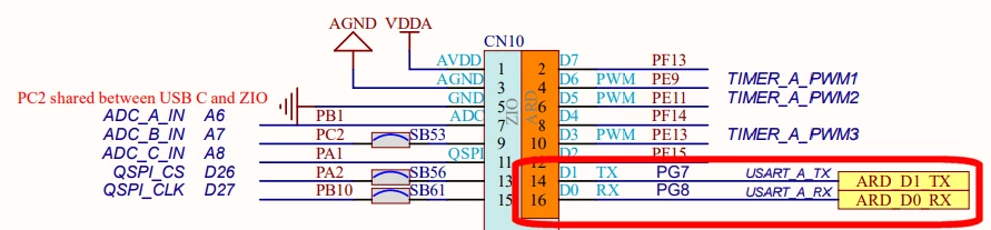

I suspect a pin conflict but reading the documentations, I was not able to find the problem?
It's here:
Both the NUCLEO-U575ZI-Q and the X-NUCLEO-WB05KN1 are driving their VCP onto the Arduino D0-D1 pins.
You're going to have to disable one of them.

As long as I understood, these pins are used for the UART communications between the NUCLEO-U575ZI-Q and the X-NUCLEO-WB05KN1.
In my mind this can't be the problem because when mounted alone on the NUCLEO-U575ZI-Q, I could used the X-NUCLEO-WB05KN1 (using the SensorDemo_BLESensor-App example project). I used ST BLE Sensor APP for smartphone and I could see the bluetooth signal and received data.
I only got a problem when I add the IKS4A1 shield between the X-NUCLEO-WB05KN1 and the NUCLEO-U575ZI-Q. It seems not to work anymore (still using SensorDemo_BLESensor-App) = with ST BLE Sensor I can't see anymore the bluetooth signal.
Andrew Neil
December 9, 2024
Ah yes, my mistake - they are swapped TX-RX and RX-TX.
