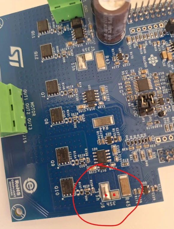

I'm looking at a diagram of the X-NUCLEO-IHM08M1 and the manual states that you can select either 1 shunt or 3 shunts using jumpers J5 and J6.
By default, there is one shunt, but when tested with a multimeter, there is continuity between the two red points in the photo:
With the multimeter, I should be getting a reading of 10 m? on the tin, right? And between the tin and the other plate?

At a glance through the schematics of the X-NUCLEO-IHM08M1, you will find on J6 (similar for J5) the two signals Vshunt_2 and Vshunt_3, each of which leads to a shunt with 10m?. All of these shunts are connected to GND, so you should measure 20m? between the signals - which ordinary multimeters usually cannot distinguish.
Hope that helps?
Regards
/Peter

@luke514  wrote:
I should be getting a reading of 10 M? on the tin, right?
Did you mean M? - or m?  ?
luke514Author
Aug 22, 2026 5:09 PM UTC
You're right, I made a mistake... it's m?

luke514Author
Thanks for clarifying that.
So, correct me if Im wrong, but if I want three shunts I remove the current solder and reposition it in the opposite direction (from vertical to horizontal, as shown in the photo in the first post)
Peter BENSCH
Aug 22, 2026 5:10 PM UTC
Yes, but not only for J6, but also for J5.
