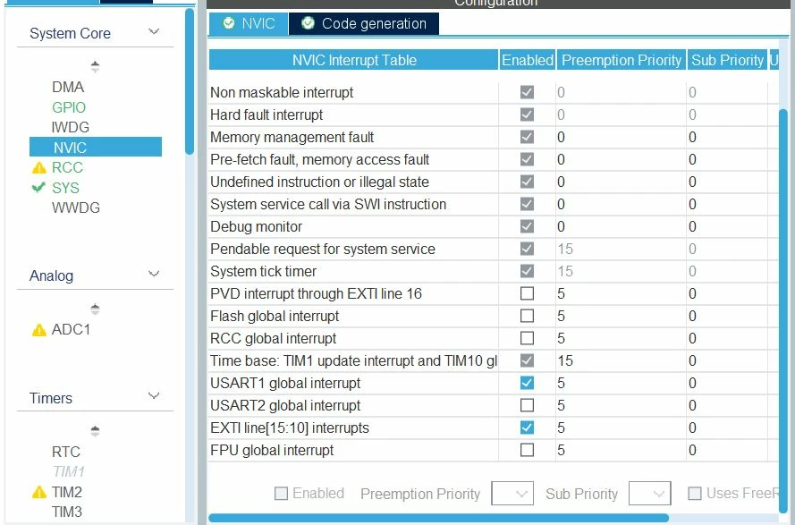

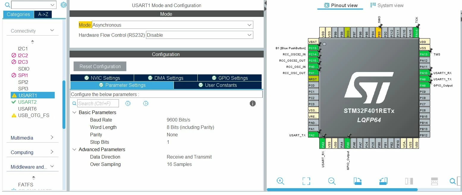

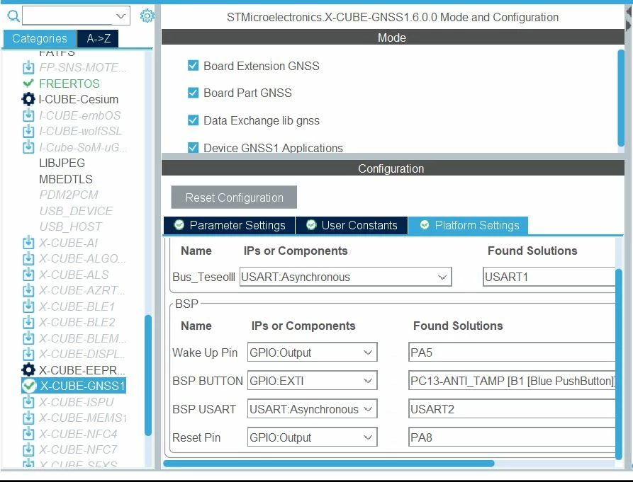

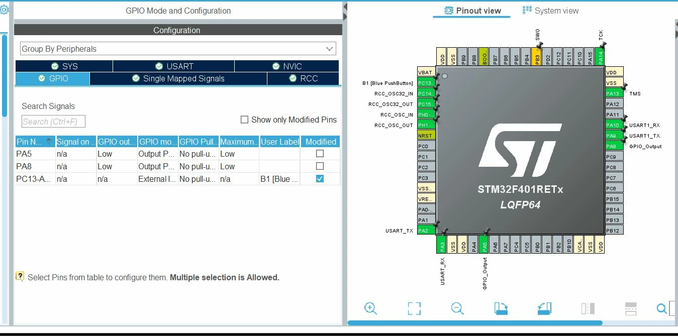

thank you for the answer. Regarding the settings - I must copy ports, interfaces settings and middelware package settings (X-CUBE-GNSS1 - change for VIC3DA, without using RTOS - RTOS disabled), according to set pictures below?
- pionout and port settings for connection with X-NUCLEO-GNSS2A1 board:
- interrupts (USART):
- USART1, change BR to 115200:
- settings of GNSS1 package, we are disabing RTOS (here is still enabled, thig to change):

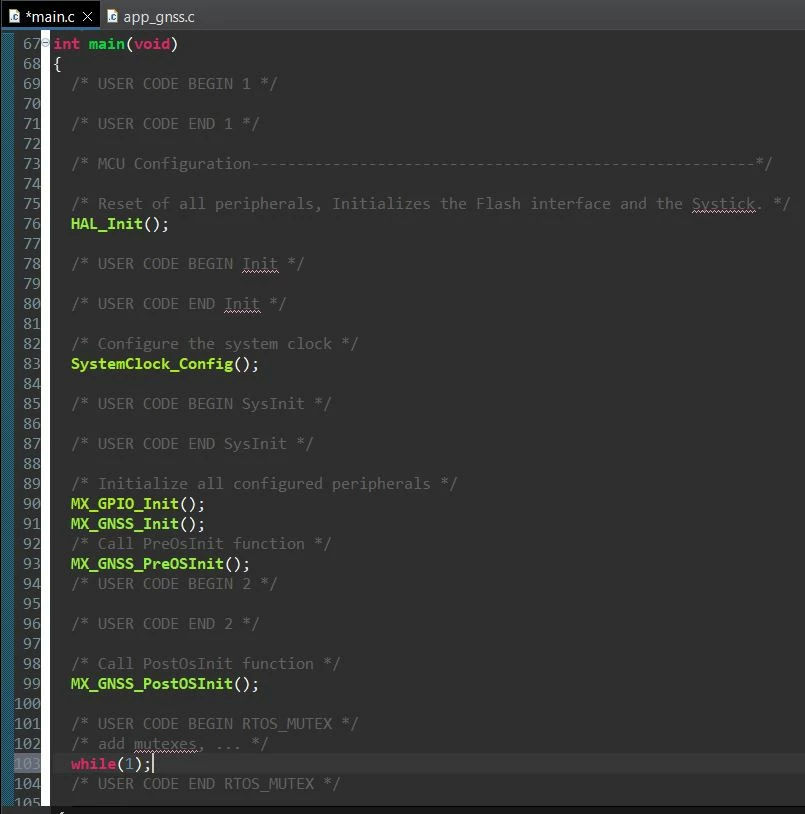

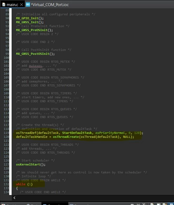

And the last needed thing - to use two mentioned functions (Consumer and ParseTask) - I must comment these lines marked as red in main.c --> main(), as placed below (if I want to use/modify ready example for L476 0 GetPos - from package, it has RTOS inside) :
If something is missing, please correct me.

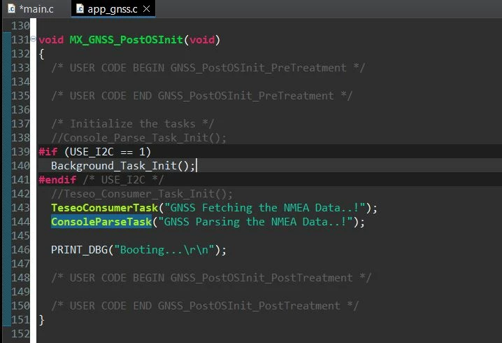

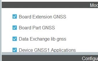

Few more things, can you explain mi how to use these two functions (TeseoConsumerTask, ConsoleParseTask)? Where put them, in main()? They are associated with thread, so where should I put a comment to make the unassociated? And the last thing, which extensions should be chosen:
- all?
Hope it is all, what I will need t know, I will try to make it work on the weekend...
Saurabh.Rawat
July 10, 2023
Hello ,
Since you are not using RTOS you have to devise your own way to simultaneously receive and parse the NMEA data.
You may call TeseoConsumerTask and ConsoleParseTask  inside MX_GNSS_PostOSInit or in a main while loop.
Dont call _init ( where above two functions are associated with the thread) .
You can pass a const parameter in above two functions soemthing like :  TeseoConsumerTask("GNSS Fetching the NMEA Data..!"); and  ConsoleParseTask("GNSS Parsing the NMEA Data..!"); .
We haven't tried without RTOS but above sequence should work. Please try.
Regards,
Saurabh
There are osthread handlers which are .
PDobr.1
PDobr.1Author
July 10, 2023
Thanks for an answer. The best way, I think, the fastest one, is:
  • take NUCLEO-F401 (for which originally Virtual_COM_Port.ioc is dedicated - so there will be no need to change settings),
  • download the code for Virtual_COM_Port,
  • make changes you mentioned earlier (described at the photos below):
 (above - commented _init functions and added TeseoConsumerTask("GNSS Fetching the NMEA Data..!"); and  ConsoleParseTask("GNSS Parsing the NMEA Data..!"); )
 (above - main() with added while(1);
  • and run it.
It compiles without errors, I'll try it in the evening and send fedback - if it works or not.
