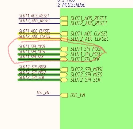

First I tried to communicate with the first ADS from the slot A and after a bunch attempts and fails I start checking the schematics I found this Error in schematics

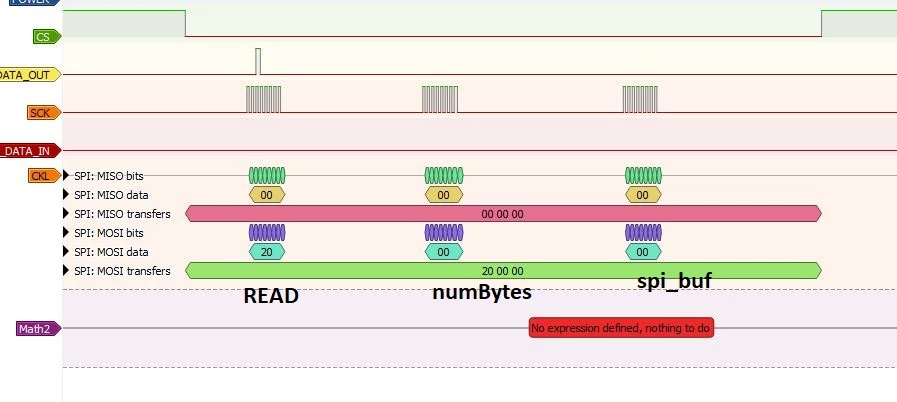

MISO is connected to MOSI! that means that those 4 ADS from Slot A can not be used for moment. I decided to use the Slot B because that one looks connected properly and here I was going nowhere. I was just not getting any response from the ADS , below is the picture from logic annalizer
Capture3.JPG  a quick explanation: according to the documentation the ADS comunicates i 2 byte format. First tels what to do :Read or Write and the second the Address of the register.
So I decided to start with the basic one, READ the ID register (I named it numBytes ,read=0x20 and ID=0x00)  spi_ buf is just a buffer were the return info should be placed and here were it comes the best the return response on MISO from ADS is always 0.
Can anyone:
1. Explain why the Slot A has that weird wiring? Only thing that I found in documentation of STM is that in Master-Master mode the MOSI and MISO are bidirectional lines.
2. Why on the Slot B even with right wiring still no response from the ADS?

Initialize the pins as GPIO outputs and toggle them manually and verify they show up on your logic analyzer. That will ensure you're monitoring what you think you're monitoring.
Ensure pins are correctly initialized. We're only getting a glimpse of the wiring here.
After that, if the chip is powered, it should respond. Issue is probably in the details somewhere.
Who designed the board? That's who you should ask about slot A issues. You can't swap MISO/MOSI on STM32F4. On some other families you can. Could also be wired correctly and just mis-labeled.

September 29, 2024
I mean, you can see the signal in the logic analyzer and it looks correct. So it's probably not a code issue. CS, SCK and MOSI all behave as expected. Whatever the reason is for MISO not responding, it's not due to the signal being incorrect. Could be that MISO is not hooked up, or hooked up incorrectly, or chip is not powered correctly, or some other wiring mismatch.

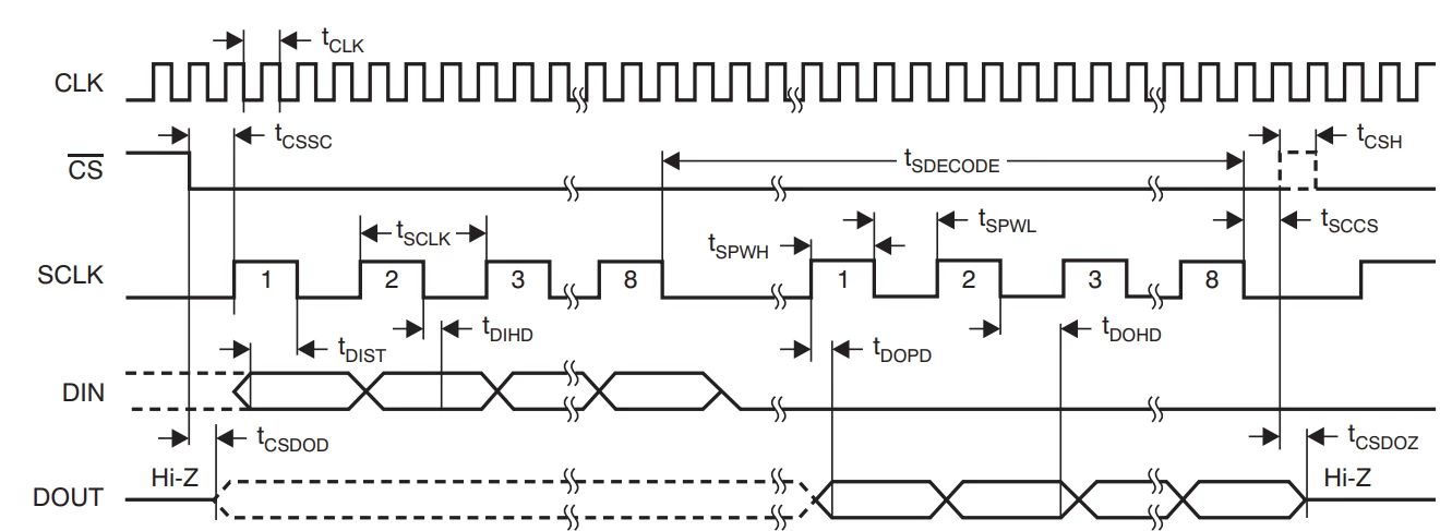

QSHAO.1
October 25, 2024
With what shown in Analyzer, it seems you are send out data successfully by driving SCK and MOSI, the only thing is no feedback received on MISO which should be driven by ADS. so pls. check MOSI pin of STM32F4 is connected to DIN pin of ADS, and MISO pin of STM32F4 is connected to DOUT of ADS.
below is SPI communication waveform in ADS datasheet,FYI.
