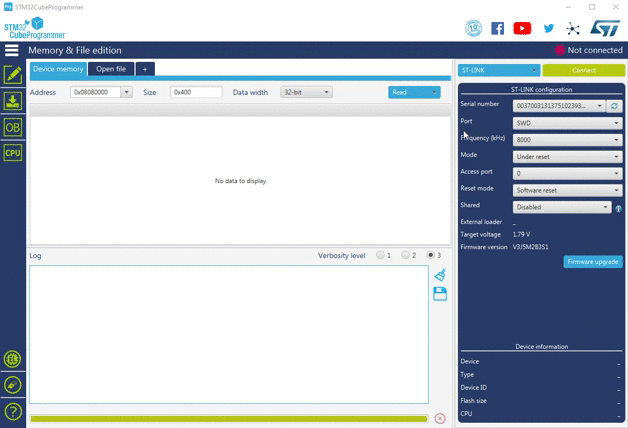

i am using st link v3. with stm32 cube programmer v2.4.0.
hardware = stm32L071
set the RDP level to AA.
i can write the eeprom only once on same address, if i try to change the value on same address then cube programmer is block. please take look on image.

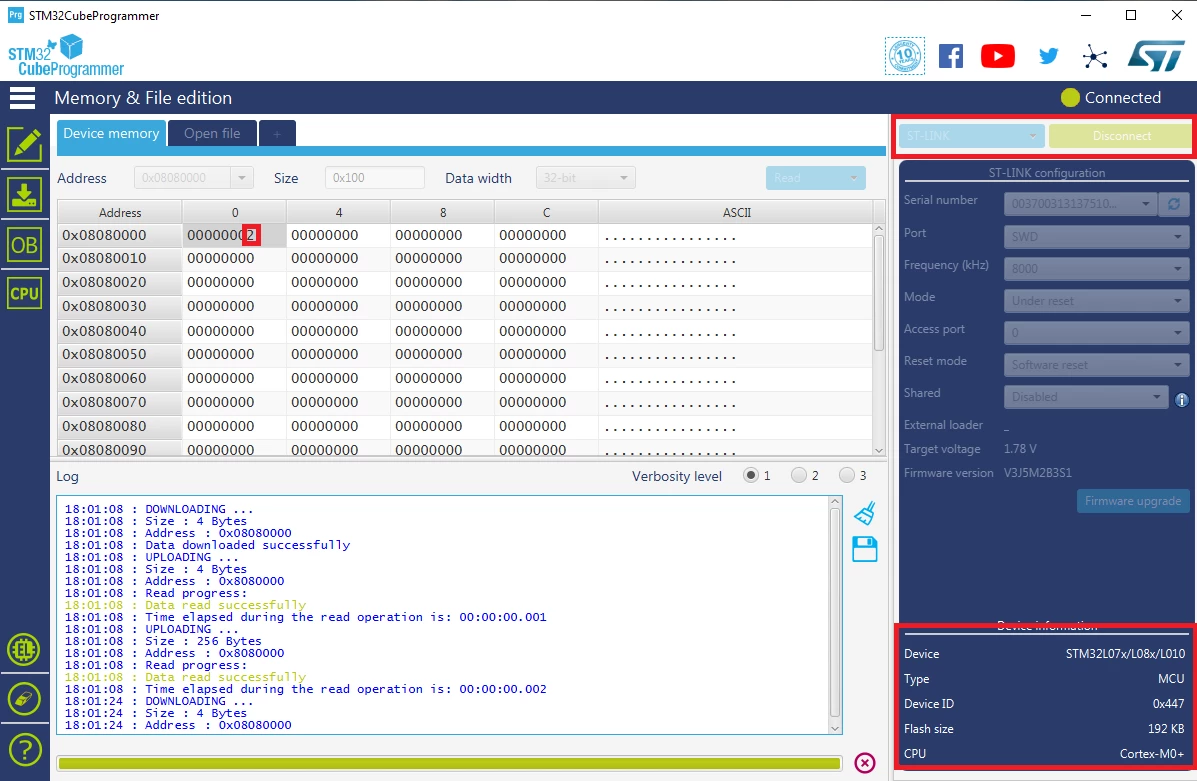

first i read the address 0x08080000. i try to write 2 on the 4th byte. it was written successfully after that if i try to chang the same value to 3 then cube programmer blocked.i can not disconnect the device and eeprom value is also not updated .

You need to erase the eeprom cel before rewrite!

thank you for quick reply. there is no option in cubeprogrammer to erase the eeprom memory. if i try to write Zeros(0) inside cell before rewriting, still this is also not working.
here is log form rewirting. cube pro is trying to erase but not successfull.
19:28:09:433 : DOWNLOADING ...
19:28:09:433 : Size : 4 Bytes
19:28:09:433 : Address : 0x08080010
19:28:09:434 : Memory edition...
19:28:09:434 : Reading data...
19:28:09:434 : r ap 0 @0x08080010 0x00000004 bytes
19:28:09:435 : Reading data...
19:28:09:435 : r ap 0 @0x00000000 0x00000000 bytes
19:28:09:624 : Memory erase...
