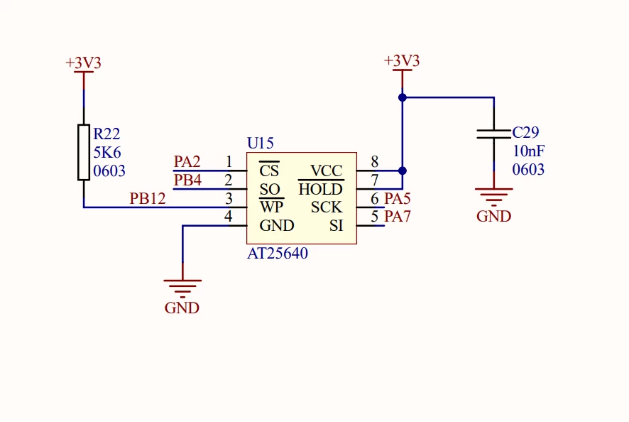

Hi forum I am working with micro STM32F429 and I want to read and write an external memory using SPI.
I am following the instructions on the datasheet but sometimes I am able to write sometimes it fails and I am not able to understand why..
Here there is the code of the init of the SPI
void SPI1_Init(void)
	/* PA2 = CS,PA5 = SCK, PA7 = SPI1_MOSI */

I am wondering if it is iìok the code since in this project they decided to not use the HAL.
In the attachements you can find al the connection of the eprom with the pin of the mcu.
Thanks a lot if you have time to watch and help

>>..the code since in this project they decided to not use the HAL.
So is it your code, or someone else's?
If it's not working for you, and you're having to debug it, at some point it might be easier to implement it cleanly, yourself.
It does seem to use a mishmash of concepts.
Uses interrupts, but still blocks.
Weird use of semi-colons on the else statements..
I might watch the CS signals vs clock/data. Make sure the IO completes to the pin, probably should be using BSRR, and __DMB() memory barrier so the write buffers flush predictably.
Perhaps use scope, or logic analyzer, triggered when you see failure.

Hi Tesla thanks for the answer..
The code it is not mine they asked the hep for finding the bug.
I would use the hal lib if I could but they decided to avoid them ..
I thinks HAL_SPI_transmit() in blocking mode shoud do the job quite well
I found someone complaining the same kind of problem ..
https://forum.arduino.cc/t/having-trouble-with-a-at25640b-eeprom/170756
They fixed with a delay between the wren command and the command for writing..
But They use total different functions..
Except to watch the signals do you see something strange?
