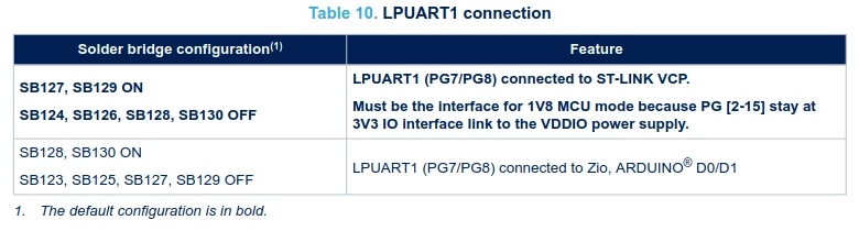

Hi, I am trying to configure and use the LPUART on my STM32L552 board. From the user manual I deduce that the LPUART is connected to the ST-LINK by default, through a VCP.

Now, my problem is that the writes to the AFR register never happens. When I inspect all relevant registers in GDB they appear to receive the right value. However, the reset value for the AFR register is 0x00000000, and it remains that way even after I've 'written' to it. I am not sure why this is.
Does anyone have any guess?
