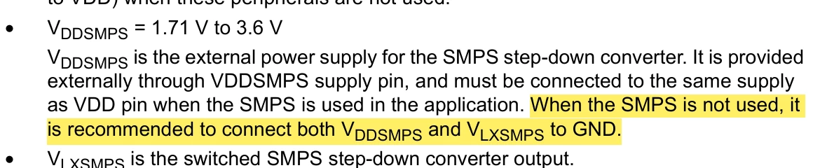

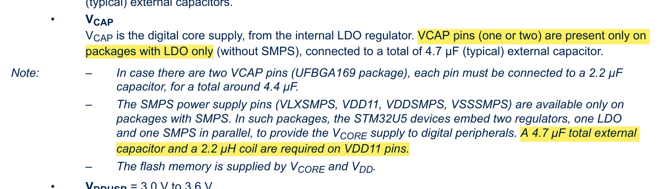

I am referring to the note AN5373 and MB1550/1549 schematics to design a STM32U575xx based board. The note AN5373 shows no connection for the VLXSMPS and VDDSMPS  pins when SMPS is not used. Do i just leave them floating? How should I connect them if I do not want to use the SMPS? Also there is no 'VCAP' pin on my symbol.

Connect them to GND, per the Reference Manual.
What is the full part number of the chip you are using?

TDKBest answer
Oct 14, 2025 7:27 PM UTC

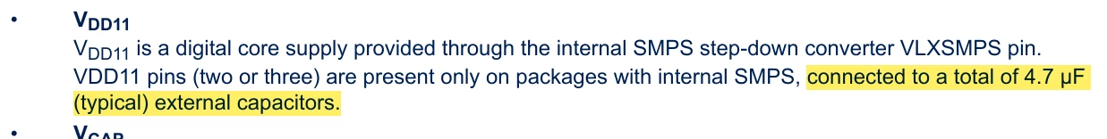

Oct 14, 2025 10:23 PM UTC
My first reply should be what you need then. VDD11 are effectively your VCAP pins here. A 2.2 uF cap bypassed to ground on each pin will work.
