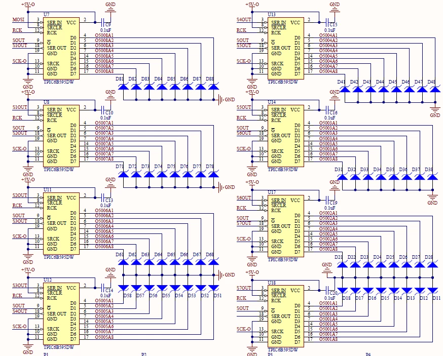

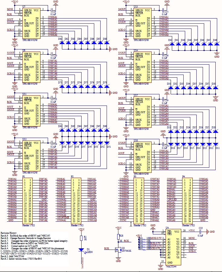

Using NUCLEO-H743ZI2, but SPI not working properly on my I/O board with chain of TPIC6B595 shift register from TI.

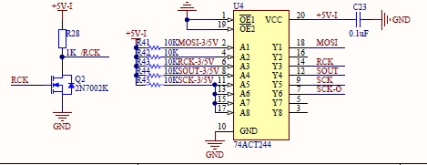

8 TPIC6B595s are daisy chain thru a buffer chip 74ACT244.

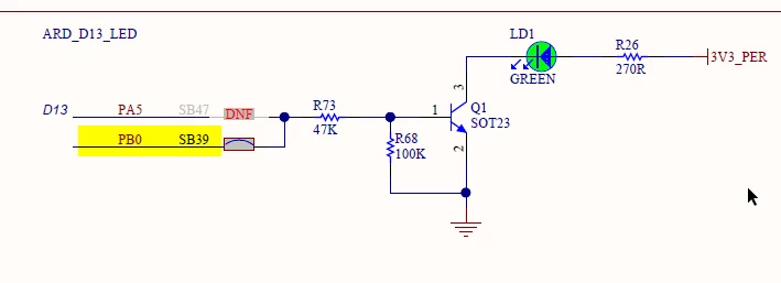

Master Mode on H743, 3 wire SPI, one GPIO LED1 on PB0

Driving the chip select signal where?

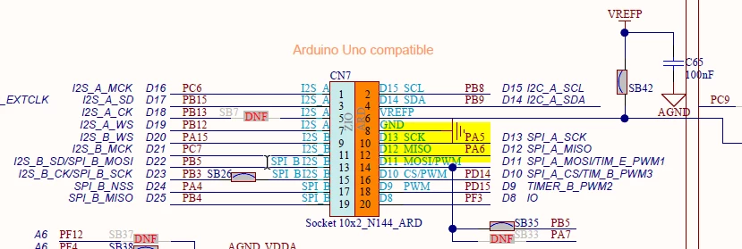

H743ZI2 to I/O
PB0 ---> RCK-3//5V
D11 ---> MOSI-3/5V
D12 ---> MISO
D13 ---> SCK-3/5V
GOUND ----> SOUT-3/5V
Thank you.
