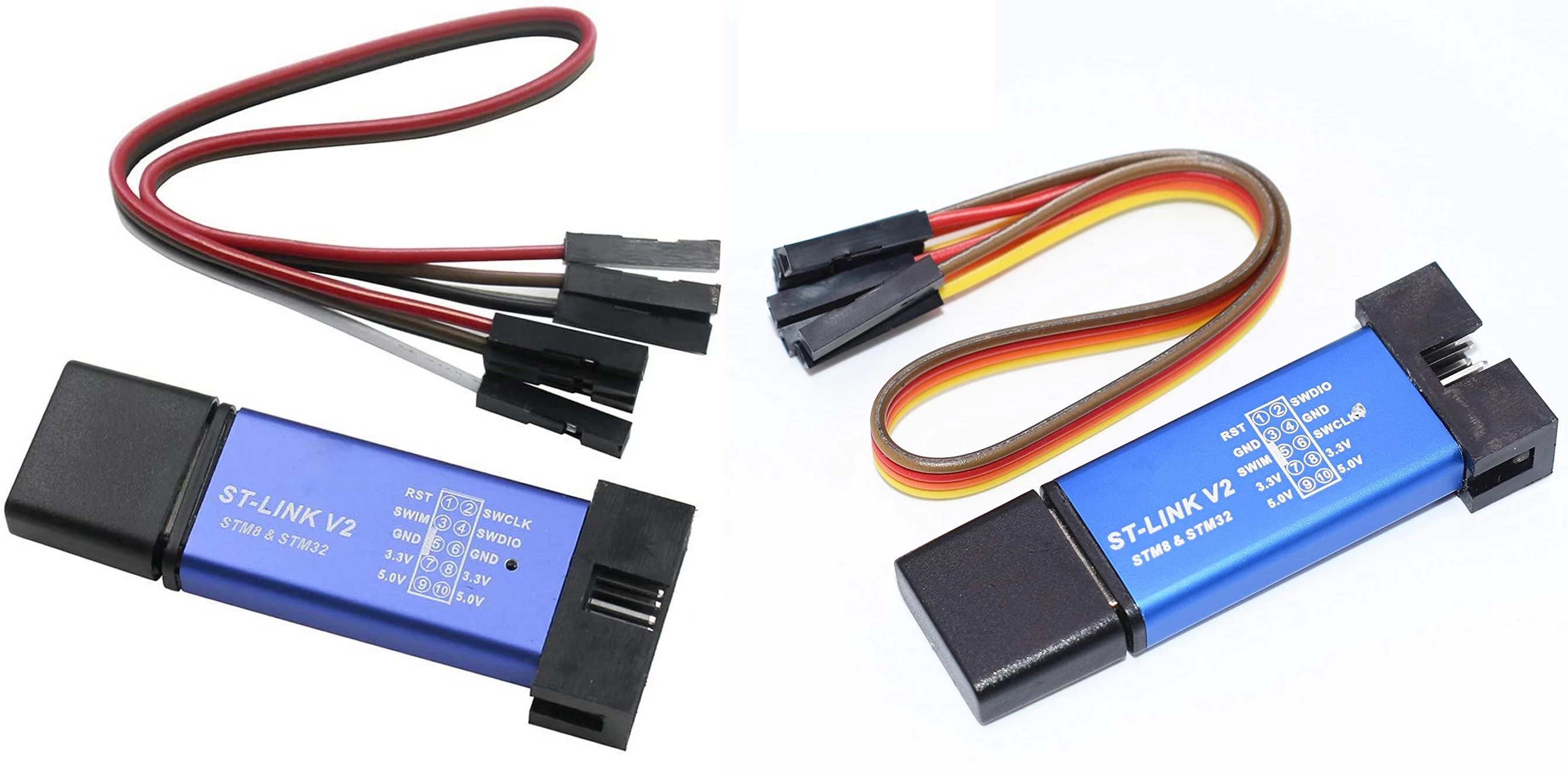

Andrew Neil
July 5, 2022
@Community member​ "Apt to lack protection components more expensive designs might include. ie ESD or buffers on the JTAG signals."
+1
Also, more expensive models (including the standalone ST-Link/V2) support & auto-detect a range of target voltages - but I've only seen Chinese clones fixed at 3.3V.
Another thing is that there's no standard pinout, and it does vary!! :o
So, if you've got more than one, it's possible that they have different pinouts - which could cause damage...
Andrew Neil
July 5, 2022
Here's an example - look carefully at the pinout legends on these two:
