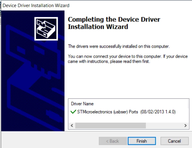

Why my Win10 PC keep downloading STM32 Virtual COM Port Driver Version 1.4 instead of 1.5?
0693W000003PPkLQAW.pngI went onto the website to download their STM32 Virtual COM Port Driver Version 1.5 but instead my installation kept ending with Driver Version 1.4 being downloaded. Another problem is there is no Flash Loader Demonstrator.

Please download drivers from there : https://www.st.com/en/development-tools/stsw-link009.html
It should be v2.01.
Better to uninstall previous ones before.
