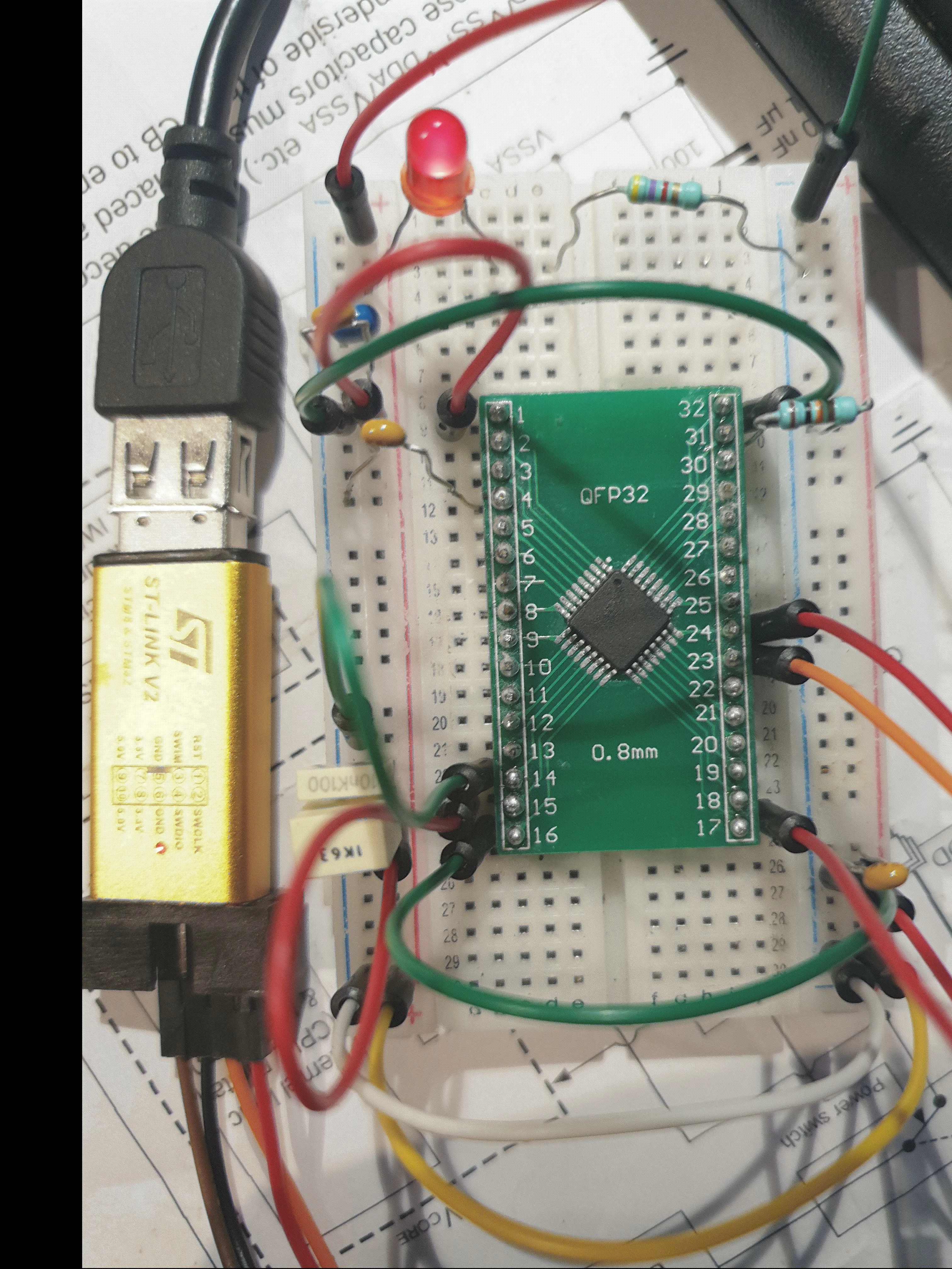

Why my MCU is not detected
In the picture:
pin 1 top left: VDD 3.3V
4 100n to GRND
14 to GRND
15 to VDD
16 to GRND
on their left 1µ and 10n F decoupling VDDA VSSA
pin 32 top right : VSS 0V GRND
pin 31 10K ohm to GRND
24 SWD clk
23 SWD dio
17 to GRND
top left and bottom right 100nF decoup. PWRS + the blue one 4.7µF
tried many combinations: with the reset on/off , boot0 on/off, swapped 23/34 ,
the ideMXcube and the standalone programmer wont see the MCU:
target not found,
ps: the red LED in ON .
my stlink v2 works in this setup with: another nucleo G4 and the generic "blue pill" fine.
Any help or suggestions ?
Thank you in advance.

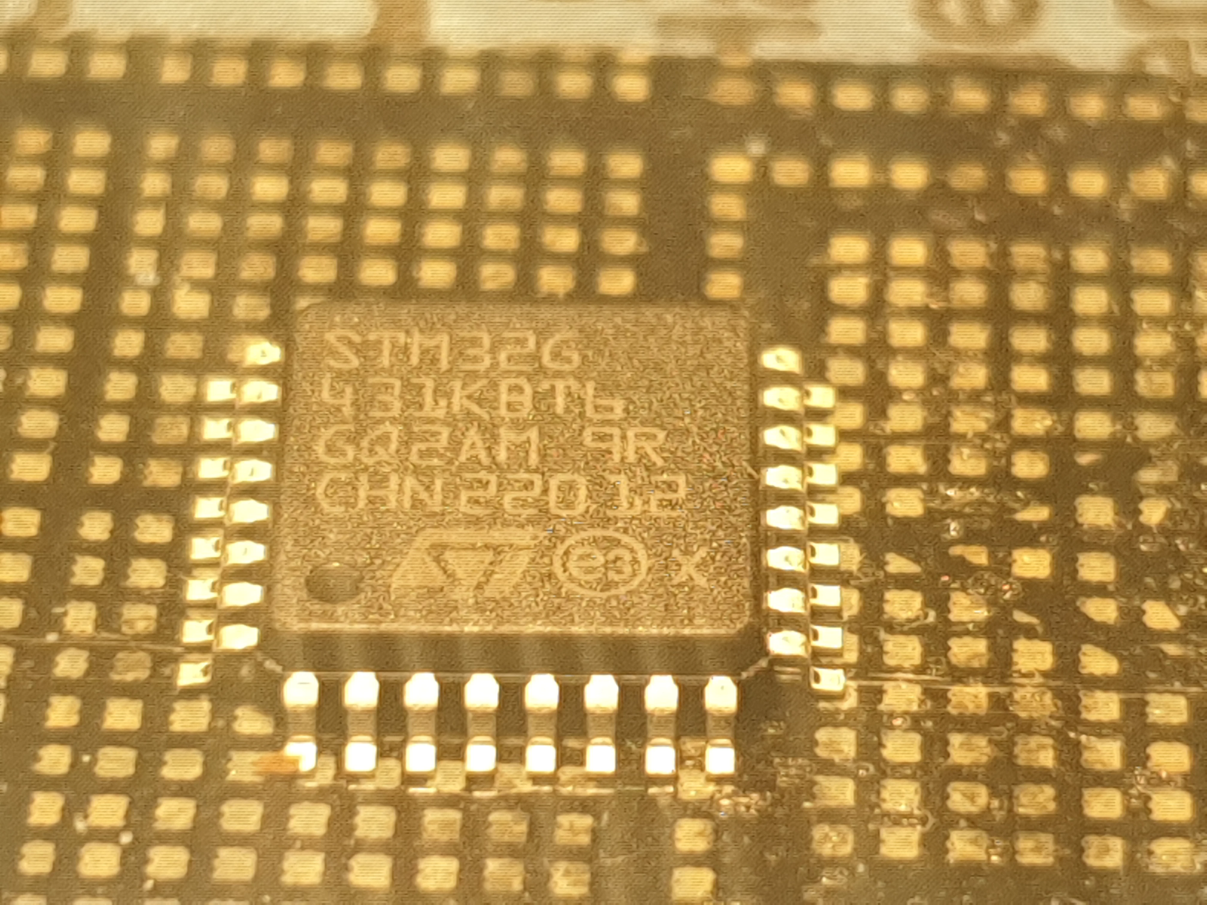

Tesla DeLorean
Guru
September 23, 2022
Lack of any markings, are you sure this is a functional part.
remi2
remi2Author
September 23, 2022
I have just got three of these from farnell, the soldered one got too much flux ... :)
photo attached.
remi2
remi2Author
September 23, 2022
FYI, to solder the SMD, I used glue to hold the chip in place.
I didnt use wood glue, especially not superglue,
but paper glue, like we use in class rooms.
So my thought is that this glue has a resistance, maybe pins are shortcut-ted underneath,
I have just mesured the resistance of the glue, it is about 0.3 Mohm -> 300Kohm .
And yet the LED lights up .
I will retest after a while (more dried glue)
And then will try to clean up underneath the chip ...
Regards
remi2
remi2Author
October 3, 2022
Made another board, this time, no glue and no overheat, I soldered so quickly , I held the chip with my finger and didn't get burned ...
my question, BTW:
Am I missing the quartz ? because I taught, this chip can start with its own RC clock ...
Also, I am powering up the board with stlink2 's 3.3v , yes the stlink is a clone ...
Regards
Tesla DeLorean
Guru
October 3, 2022
The STM32 typically start from HSI or MSI, you have to manually start the HSE external one.
The secondary signs-of-life is sending the 0x7F data pattern via UART into the system loader. See AN2606, and AN3155
AScha.3
October 3, 2022
>this chip can start with its own RC clock.
right so.
you should see the clock tree in Cube or STM32cubeIDE ...right?
