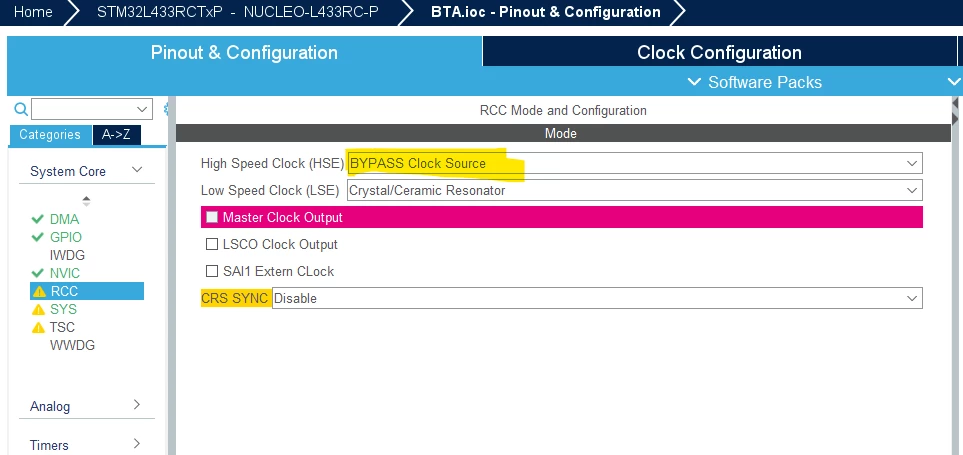

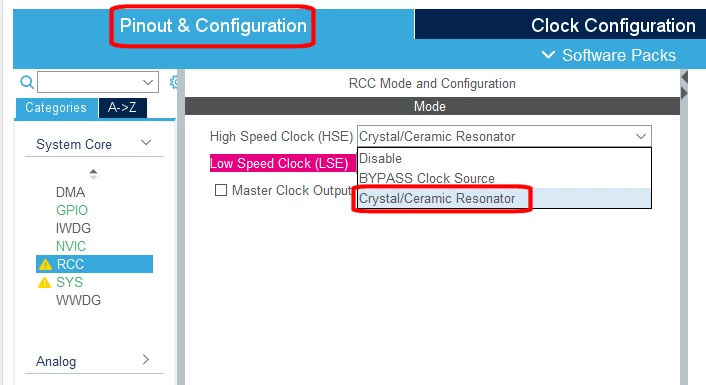

Andrew Neil
November 27, 2025
@freeflyer wrote:
SystemClock_Config (generated by CubeMX) has the line...
RCC_OscInitStruct.HSEState = RCC_HSE_BYPASS;
So, yes - that is in Bypass mode.
That means the oscillator is bypassed: it is expecting an externally-generated clock signal - eg, from the ST-Link.
A crystal will not work with this setup.
@freeflyer wrote:
how do I change this setting in CubeMx .
Here:

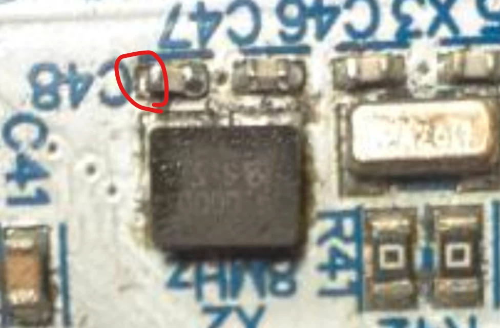

November 27, 2025
The X2 part looks off-center. May not be a great connection there. If you use a heat gun, which you'll pretty much have to do with that part, it should self-center when the solder flows if there is sufficient flux.
Also this joint doesn't look great. Hard to tell.
What you're trying should work, so likely there's a problem somewhere, hardware or software.

... and these SMD crystals with the pads only on the bottom are terrible for manual soldering.
-> use lots of soldering flux, and enough heat
+ some Nucleo soldering bridges might be so small that when removing the 0R you leave a bridge with the solder.

Thanks all, I originally soldered the components with a soldering iron but it was a very difficult task.  The capacitors are tiny (0402) and the pads on the crystal are on the bottom of the component.
I cleaned the board with IPA and then used my hot air gun to try and reflow the crystal but it still does not work.
I used Kapton tape and cut a square hole in the tape (for the crystal) to protect surrounding components.
The board has wires all over the place connecting to other development boards, so this makes it even more difficult.
My hot air gun was set to 380 degrees C, but I worry about overheating and damaging the components too.

Another problem with these crystals and the footprint:
beware the 90° mistake!
180° on the other hand are okay.

Unfortunately changing HSE to Crystal/Ceramic Resonator still has not fixed the problem.
Is it not possible to buy this development board with the 8MHz crystal and capacitors already fitted ?  Its a nightmare trying to solder them without specialised equipment, which I don't have.
The second board is now out of use, because when I used the heat gun to try and reflow the solder for the crystal and capacitors, both capacitors for the HSE crystal and one of the capacitor for the LSE crystal popped off.
