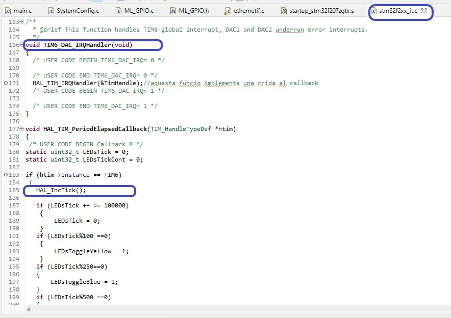

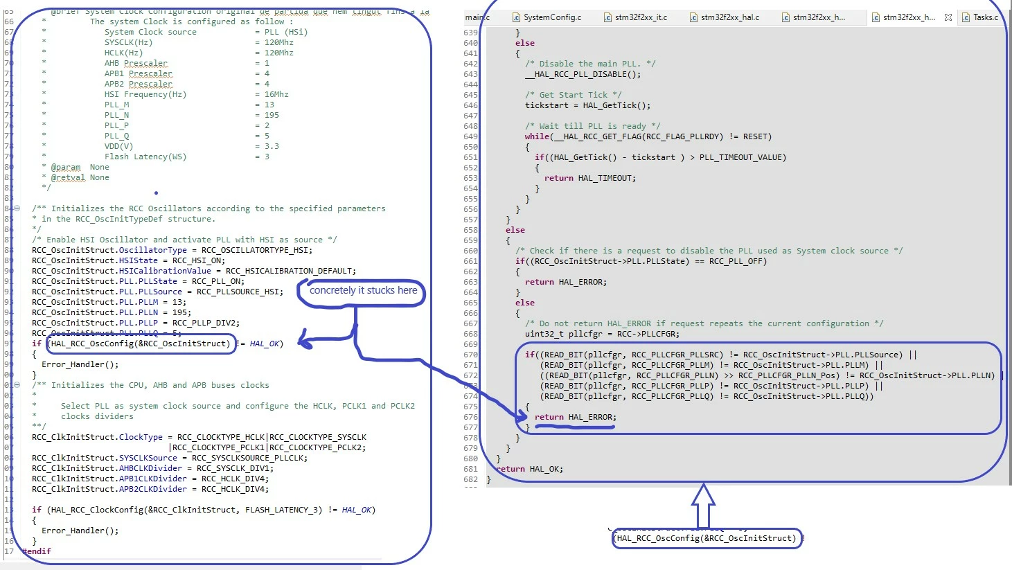

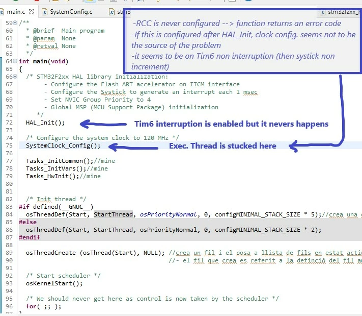

Thanks Tesla, I can answer some of your proposed list actions now:
  • IRQ handler is present (image1) but thread doesn't jump anytime there
  • thread execution stucks on RCC configuration (image2) --> it returns error code
  • PLL configuration (image2)
  • HAL_init doesn't hangs up. Function returns an OK error code, but after HAL_init enables TIM_6 interruption, interruption never happens. It happens if the code (with minimal GPIO remapping) runs on the NUCLEO board.
  • Systick_Handler interruption neither other ones don't work.

I changed one debug configuration parameter at manager debug tag.
I checked the Reset Strategy tab and I saw that it was the none option. Hence I put Type: Normal and I tried to debug once again. This doesn't work on the previous PCB version.
After doing this with the new PCB version, I'm able to debug using Segger probe. Now, interruptions and clock are working.
I think it was the Reset Strategy. Althought its seems the application to be executed partially, to debug is now possible.
