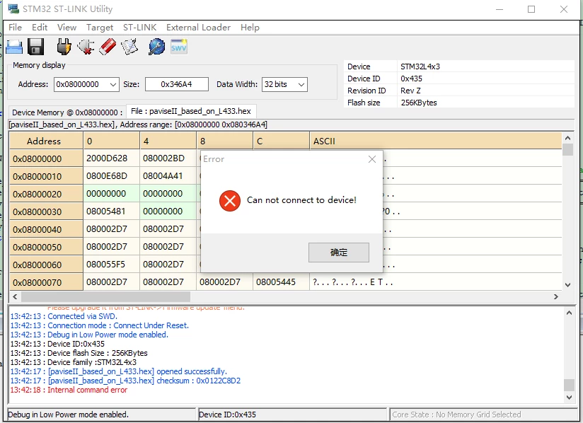

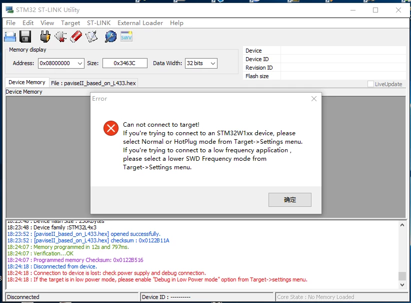

why i can not connect to STM32L433 with STM32 ST-LINK Utility

Your code, when executed, disables or changes pin settings on pins used by the debugger, or powers down the chip or interfaces? ​
