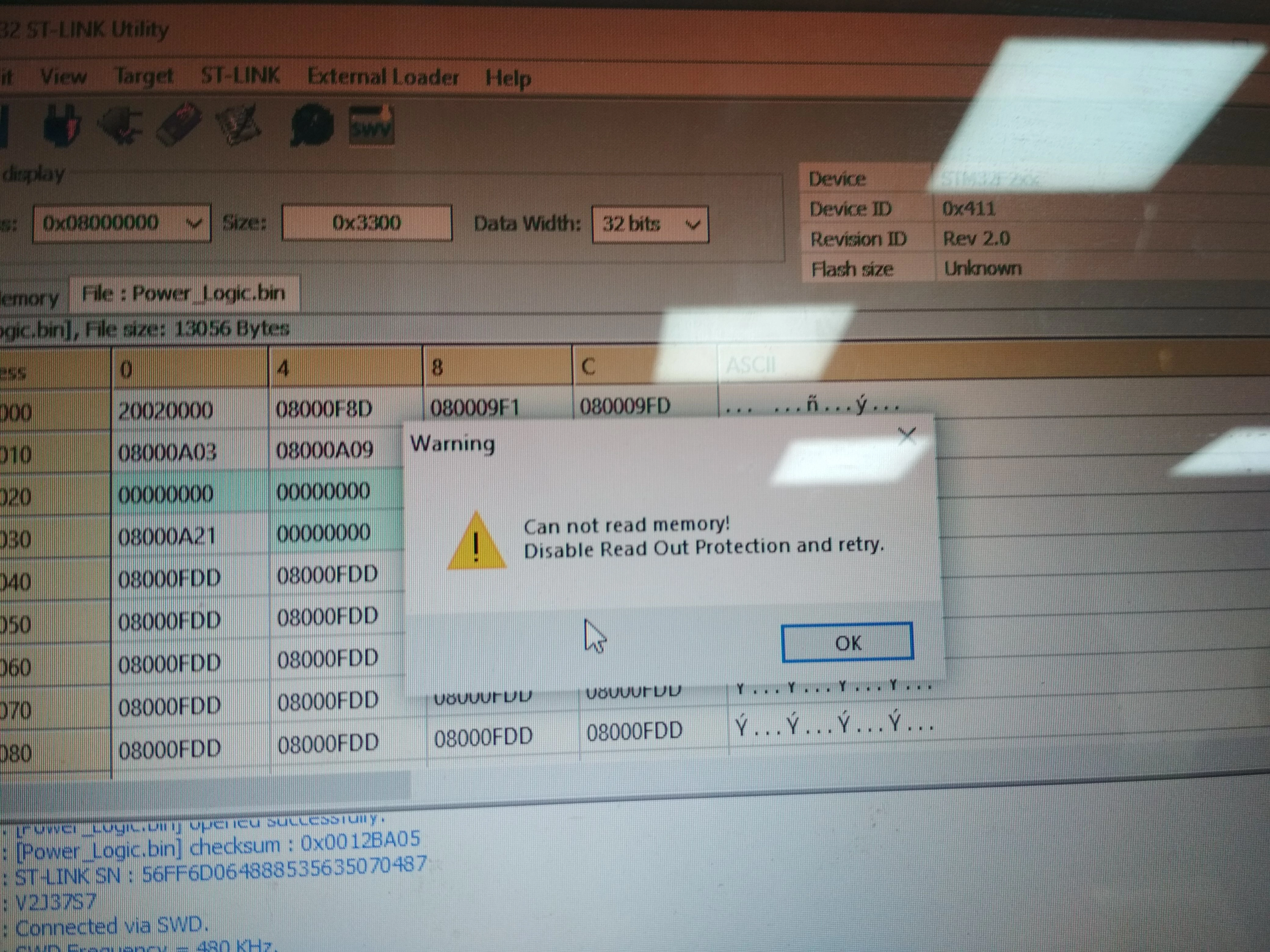

why i am getting DISABLED Read out protection error? I didnt changed anything.I can not reprogram my stm32f207 custom board .How to resolve thisissue?

The warning messages says it can't read memory because RDP is enabled. Disabling RDP can be done within the option bytes (Target -> Option Bytes). Set it to level 0 and restart.

hello, thanks TDK ,for your time and reply. I tried doing it with stm utility but I am unable to modify it.it shows same warning again. Any help would be great.
