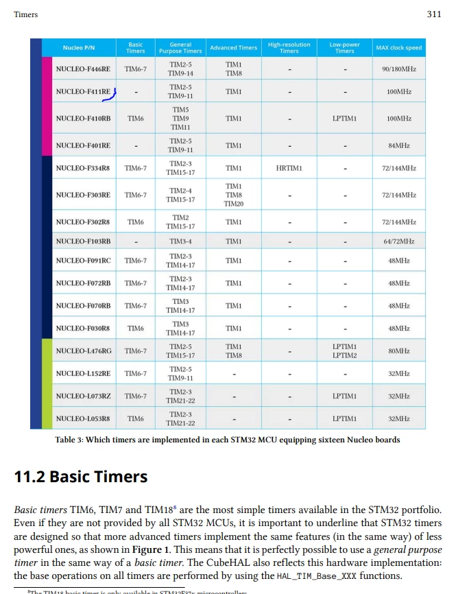

Sep 12, 2023 11:41 PM UTC
Hey @Issamos
According to this pdf p340 ( https://www.embedic.com/uploads/files/20201008/Mastering%20STM32.pdf ), TIM6 doesn't exist on STM32F4 boards:
So this macro __HAL_RCC_TIM6_CLK_ENABLE() shouldn't have been called in a STM32F4xx driver isn't it?
Should I create an issue on the Github STM32CubeF4 ( https://github.com/STMicroelectronics/STM32CubeF4 )?
TDKBest answer
Sep 13, 2023 3:39 AM UTC
It exists on some STM32F4 chips, just not yours.
stm32f4xx_hal_timebase_tim_template.c is a template file. It is meant to be modified to suite your hardware. If you aren't using a timer as a systick, you can delete it.
Unclear how you generated your files, but if you do so via CubeMX, the template file will not be included and the project will build successfully.
