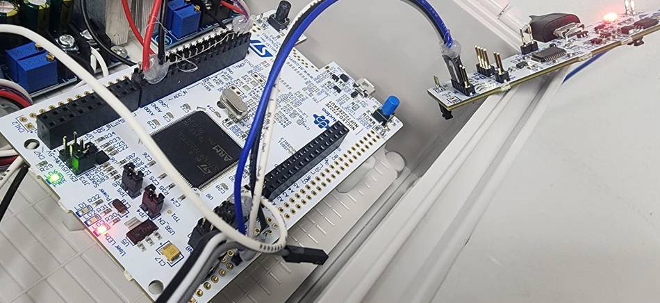

I cut the STlink board from Nucleo-F722ZE board.
I connected the cut STLINK board to the nucleo board and SWD.
To connect swd, I connected 2 (JTCK), 3 (GND), and 4 (JTMS) of the SWD connector to 13(PA13), 15(PA14), and 19(GND) of the CN11 connector of the nucleo board.
SWD con. 2(JTCK)   -   CN11 con. 15(PA14, TCK)
SWD con. 3(GND)   -  CN11 con. 19(GND)  <--- Common Ground between boards.
SWD con. 4(JTMS)  - CN11 con. 13(PA13, TMS)
The power source for the nucleo board was 5V input from the outside using 6 (E5V) and 8 (GND) of CN11.
And the cut stlink board was connected to the PC via USB.
And for the "HSE on-board oscillator from X3 crystal(not provided)" that is not provided,
I processed it as follows.
X3 soldered with 8MHz crystal.
SB8 and SB9 ON.
C37 and C38 soldered with 18pF cap.
SB148, 149, 163 OFF.
SB112 was not processed separately as it was on the stlink board.chulhoolimnnftech_2-1725847933580.png
I've confirmed that stlink with this connection works fine on other PCs.
I don't know
But it's working fine now.
After not recognizing stlink after the first program, I tried setting it to "HSE not used". Then I changed the setting to “HSE on-board oscillator from X3” again.
Now stlink is recognized well.
I guess I did something wrong.
Thank you to everyone who helped.

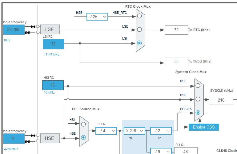

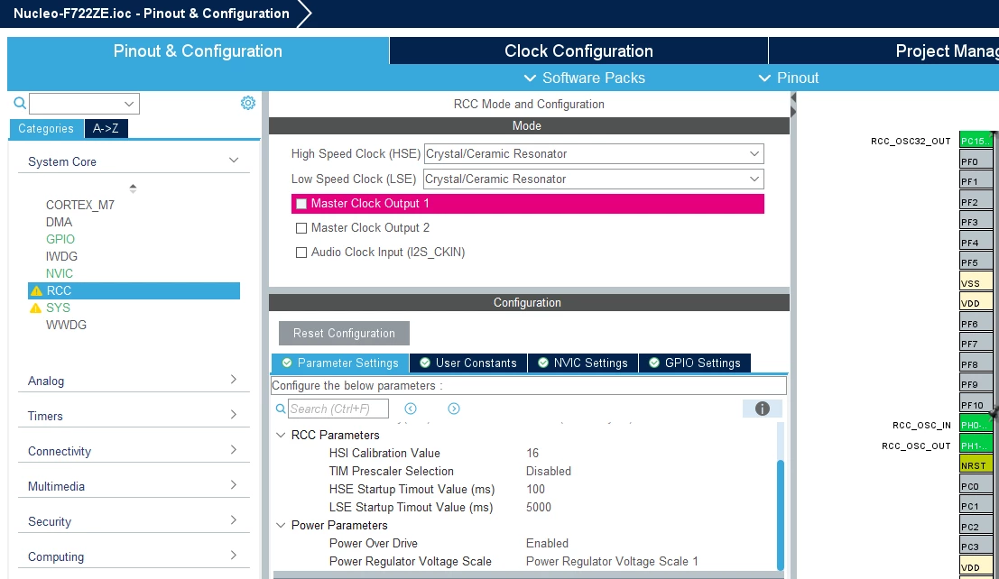

Hi.
I'm pretty sure that board is dead.
I have another board that is identical so I tested it further.
As above, I added the 8MHz oscillator and capacitor according to the manual.
And I set the RCC and clock configuration as follows:
And I checked the program download and operation through stlink.
But when I downloaded again via stlink, my cubeIDE did not recognize stlink.(It does not mean that the nucleo board is not recognized.)
I disconnected the 8MHz oscillator again, and cubeIDE recognized the nucleo board via stlink.
Why is stlink not recognized when I operate the 8MHz oscillator?
Does the HSE frequency affect the SWD frequency? Help me!!!

I downloaded the code to run HSE via stlink with the 8M oscillator not running. And when I tried to download again, cubeIDE did not recognize the stlink.
Sep 6, 2024 1:01 PM UTC
See if you can connect with standalone STM32CubeProgrammer. Try holding BOOT0 high during reset.
