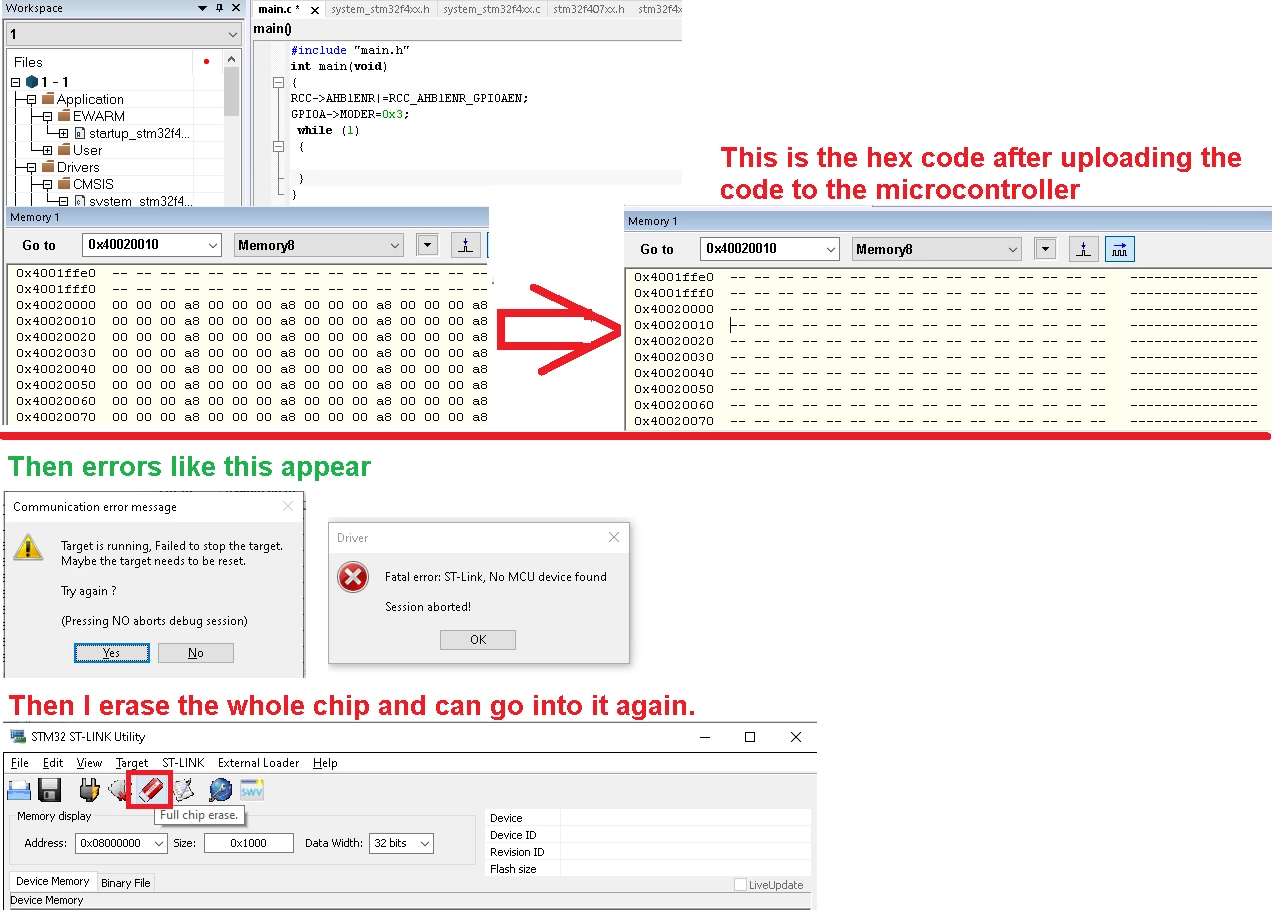

Why does setting pin 0 of port A to analog mode cause an error?
  • May 21, 2022
  • 1621 views
STM32F407VGT6
Why is access to the Microcontroller broken after this code?
The MODER register after this code should look like this: 00000000000000000000000000000011
this is Analog mode for pin 0 of port A.
int main(void)
RCC->AHB1ENR|=RCC_AHB1ENR_GPIOAEN;
GPIOA->MODER=0x3;
 while (1)
Same but with port B or C does not throw an error
RCC->AHB1ENR|=RCC_AHB1ENR_GPIOBEN;
GPIOB->MODER=0x3;
RCC->AHB1ENR|=RCC_AHB1ENR_GPIOCEN;
GPIOC->MODER=0x3;
Port A is compatible with Analog mode
A user button is connected to pin 0 of Port A, but it is not pressed, which means it does not interfere with the execution of the code.
Best answer by Piranha
You are disabling the SWD pins PA13 and PA14. Look at the GPIOx_MODER reset values at the reference manual.
MMust.5
MMust.5Author
Senior
May 21, 2022
Exactly)) Thanks.
