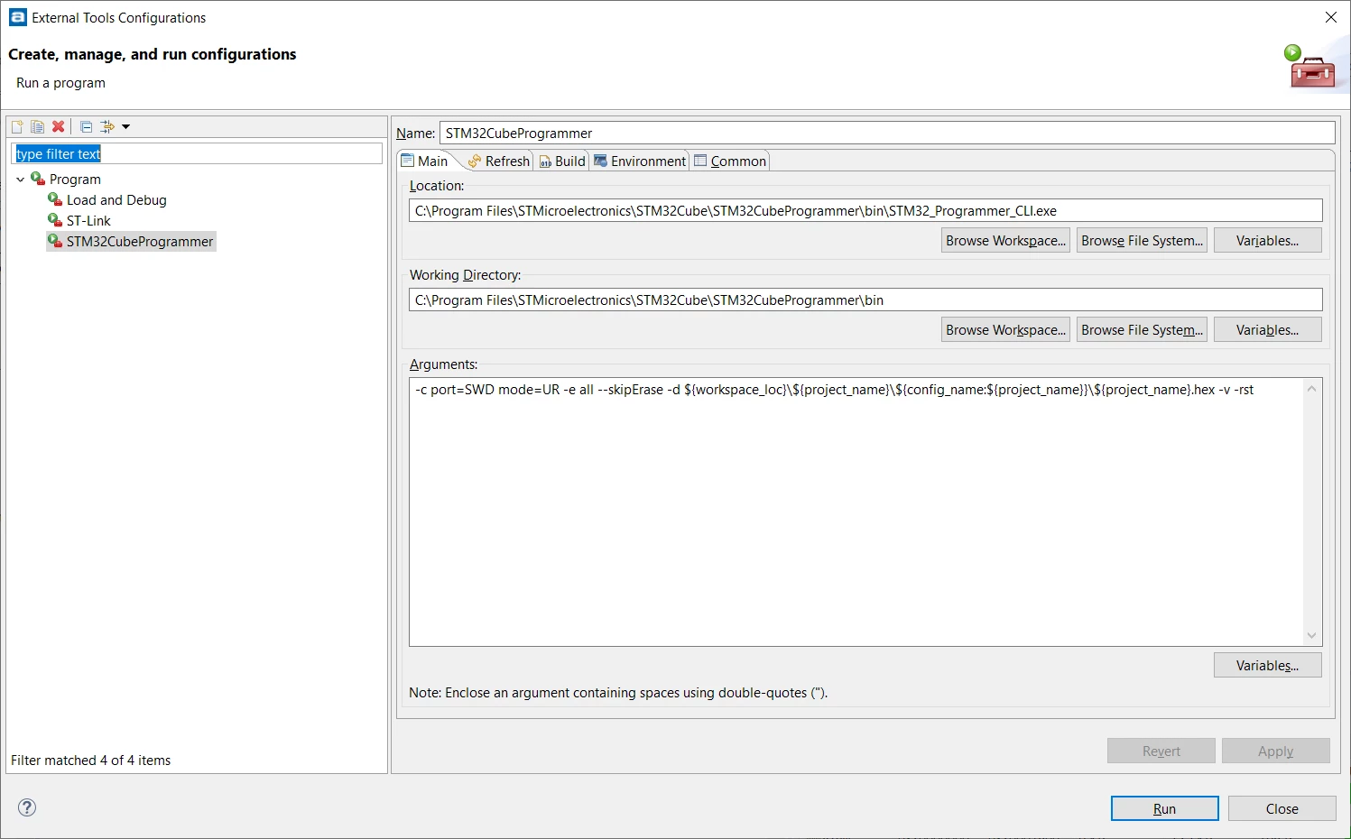

May 17, 2021
Hi Martin,
Glad that you found a solution.
I don't use CubeIDE, but Atollic TrueStudio. So in my case when I want to program the device I have to use an "External tool", from which you can call any exe you like with the arguments that you need. See attached picture.
The arguments are :
-c port=SWD mode=UR -e all --skipErase -d ${workspace_loc}\${project_name}\${config_name:${project_name}}\${project_name}.hex -v -rst
In my case I connect under reset (UR) which you don't want. I would add "-vb 3" before "-e" and after "UR"

I also use Atollic True Studio for another project and here I really have an STLink V3 connected and I also have a double reset here.
So I have the settings you describe and I set in -vb 3 which produces a lot of output. But with the solution I found above I also found a solution here and that is to delet mode=UR. Without this there is only one reset. It seems UR connects under reset but then releases reset again to reactivate it before erasing the flash and program it with the new progam.
