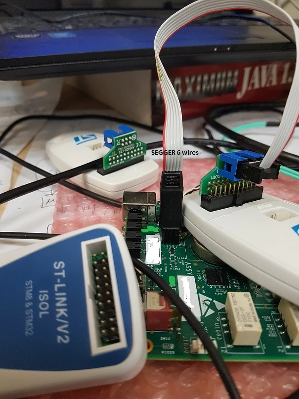

I have STM32F446 with external ST-LINK/V2 white plastic dongle.
Debug prints via ITM trace work fine with Keil uVision and ST-Link utility.
Today I got an isolating dongle ST-LINK/V2 ISOL.  Everything seems to work with it except of debug prints.
This does not look a Keil issue because ST-Link utility does not show prints either.
Are any changes in debug settings needed for ISOL?
Can anybody confirm that ITM debug prints work with ISOL?
I've connected the same target cable to the ISOL that I use with normal ST-LINK
(entire cable chain with connectors, from the dongle to the board).
The ISOL is original new item ordered directly from ST, in a nice box etc.
Thanks,
 -- pa

The SWO pin (PB3/JTDO) needs to feed over the isolator.

All the pins/wires go into the dongle (either ISOL or normal)... do you mean to reconnect SWO inside the dongle?
-- pa

So basically a Tag-Connect type system
https://www.segger.com/products/debug-probes/j-link/accessories/adapters/6-pin-needle-adapter/
Ok, so SWO is there.
I'm saying that SWO/JTDO needs to cross the isolation boundary for the SWV functionality to work properly. More generally the core clock needs to agree at both ends. Perhaps there is a bandwidth limit here? You'd need to probe/review the circuit inside the ST-LINK/V2 ISOL pod, but I'd assume it would need JTDO to support JTAG operation.
Segger's isolator bridges SWO
https://www.segger.com/products/debug-probes/j-link/accessories/isolators/j-link-swd-isolator/

The problem disappeared by itself after few resets, power cycles, shuffling ST-LINKs around and other 'ritual dances'.
Debug prints thru ITM are unfortunately bristle and can stop working even when other debugging functions and download work
