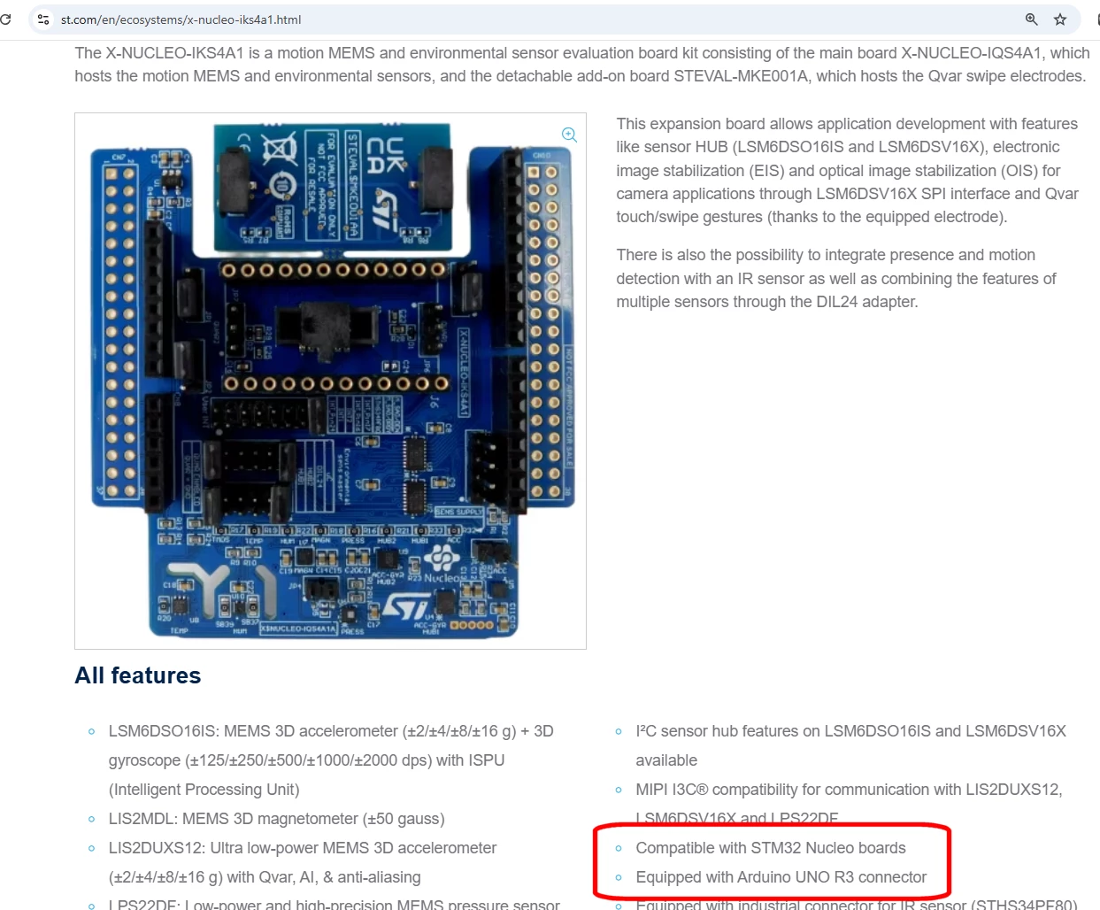

Which Nucleo boards can I use with X-NUCLEO-IKS4A1?
I currently have a NUCLEO-F411RE, will I be able to use the X-NUCLEO-IKS4A1 expansion board with this or will I need another board?
Thanks

this sensor board is using the ardunio for connection, you can use nucleo/dk boards for the connection, the board mainly use the I2C/I3C connections.

It uses the standard Arduino headers.
The whole point of those headers adopting the Arduino standard is that any other board which abides by that standard will work.
When in doubt, you can always check the schematics - they will be under 'CAD Resources' on the board's Product Page.
The pinouts will also be defined in the board's User Manual.
