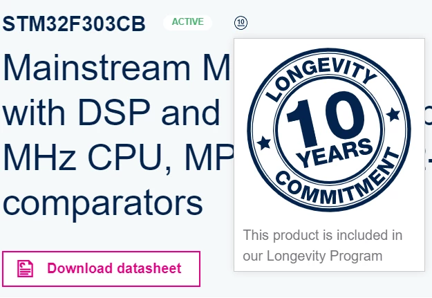

Hello @CRami.3​ and welcome to the Community :)
This product appears in the list of selected products for the 10 years Longevity commitment (link).
Hope that I've answered your question. If this the case, please close this post by clicking the Select as Best button on my reply .

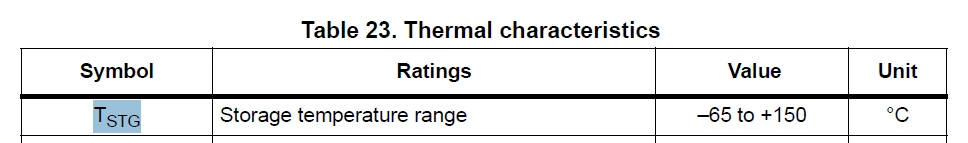

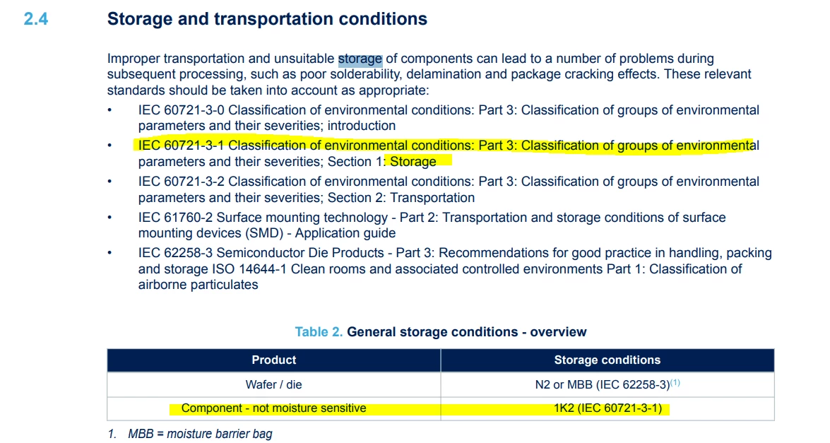

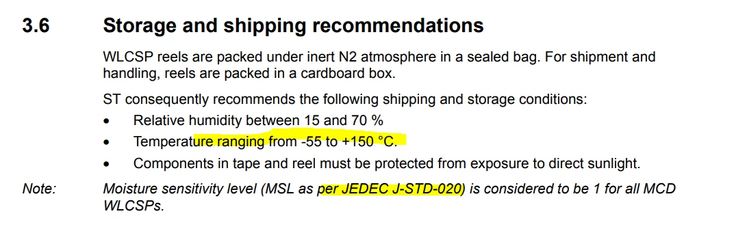

I'm looking into your request, but I only found the temperature conditions in the device datasheet.
There is also the storage and transportation conditions in the TN1224 and TN1163, but I can't find info on the maximum storage duration.
