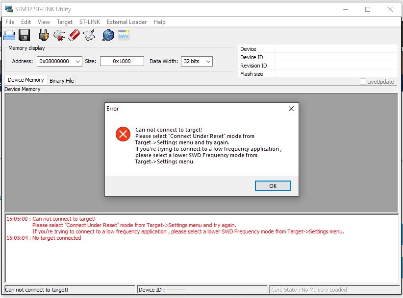

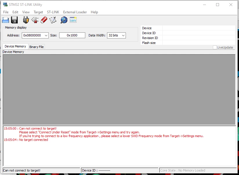

When i try to read the Controller "stm32f103c8t6 ic "using "st link v2" i get the error like this, can any one please help me to resolve this error

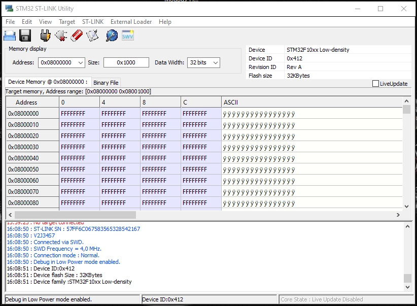

When i try one controller(stm32f103c8t6) its show details like this .0690X00000AscMXQAZ.pngWhen i connect other controller(stm32f103c8t6) its show the error like this. Please some one help to resolve this error.0690X00000AscBKQAZ.png0690X00000AscBFQAZ.png

Does you application use sleep modes, re-purpose the JTAG/SWD pins, or activate readout protection ?
Try a mass erase.

when i try to read first time its show the device id ,memory &ram After some time its show the error like this
