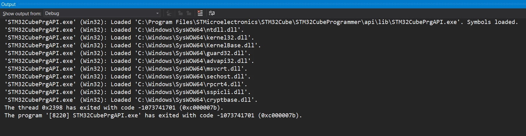

I'm struggling the same error with the STM32Cube programmer.
I want to use the example C++ api but when I build and start some of the examples I got the error 0xc000007b.
I run Windows 7 64 bit with Visual studio 2019. I have installed the redistributables package (2015-2019) and the mentioned
in the api help document SDK. In the output window I get these messages. Is it possible the problem to be caused by the cryptbase.dll file?
