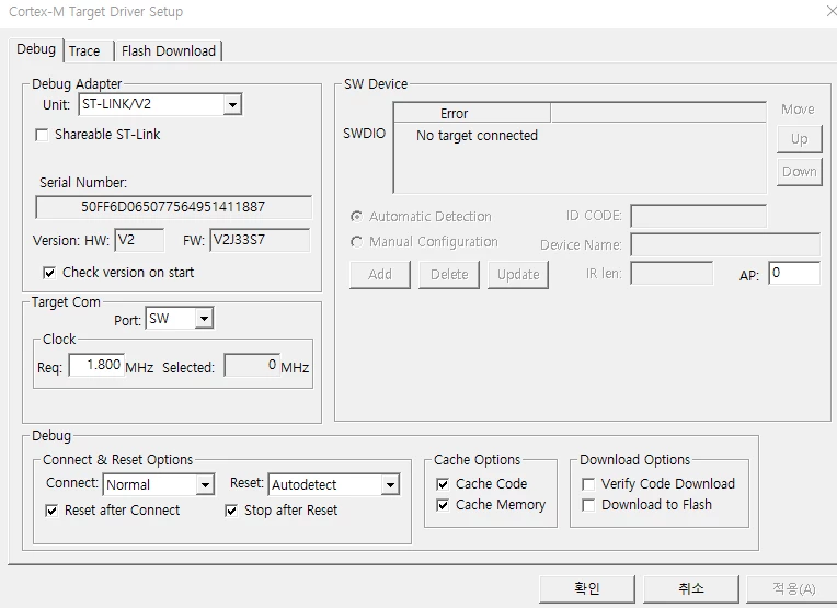

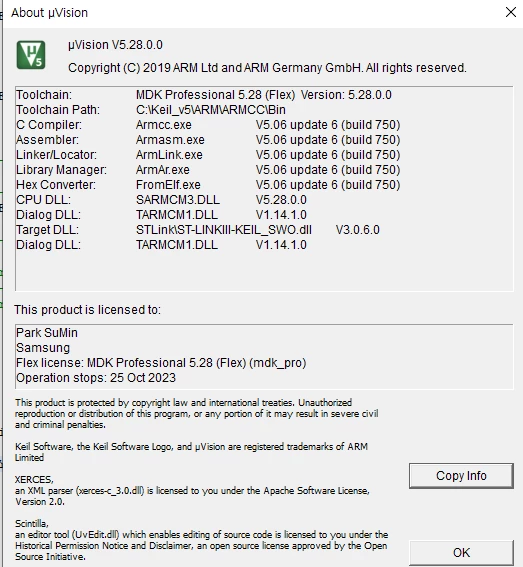

When debugging with uVision Keil, "No Target Connected" errror
  • August 8, 2023
  • 1149 views
when using STLINK/V2, it is normally debugged, but when using STLINK/V2-ISOL, it is not connected.
Can you tell me why?
2 replies
SuminAuthor
August 8, 2023
i'm using 4(GND), SWIO(7) and SWCLK(9) pin.
VDD is supplied external power (3V)
