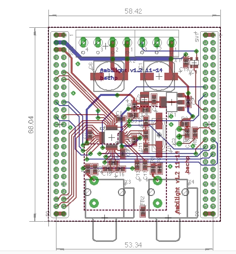

Hello
I've established that the pins on bottom of Nucleo-F767ZI (144) are ST Zio connector � CN7, CN8, CN9, CN10 (relevant 2 pages from UM are attached).
I want to create PCB on top of which I will be able to plug in the Nucleo-144 board. What should I order, can anyone share advice? I tested that board's pitch of the bottom pins is 2.54 mm (because 2.54 mm ribbon cable fits, UM doesn't mention ''pitch'' word nor shows this on the mechanical drawing). The PCB for discovery board that I need to edit is following:
Pitch between the holes on left and right is correct, 2.54 mm. But what part should I use to be able to plug in the Zio pins that are on bottom of Nucleo? After I change PCB to have  2x10 (CN7), 2x8 (CN8), 2x15 (CN9), 2x17 (CN10) series of holes, to match Zio. Is my approach overall correct? I'll be transmitting DCMI data.

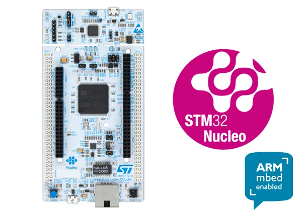

Nucleo 144 looks like this:
The 4 black female pin headers around the QFP144 are compatible with Arduino Uno (2.54mm pitch) except that more signals are accessible by doubling the rows. (they mismatch from the presented bottom board layout).
I guess the unpopulated left and right dual row connectors are called ''MORPHO'' connectors as in the Nucleo 64.
In both cases classical dual row 2.54mm pitch headers.

SSW-136-01-T-D by SAMTEC is working for us.
 Cut these to length in a band saw, and avoid distributor delays while they cut it to length.

Thanks for the tip about cutting manually. Without this the price would be huge. There are 100 contacts total in ST-Zio, so I thought about ordering
http://www.newark.com/samtec/ces-150-01-t-d/board-to-board-connector-dual/dp/15P1321
. That's the cheapest 100 way strip in Farnell. It isn't SSW series (that one costs 30% more), will it fit?

I am not sure we are on the same page. We are soldering the SSW-136-01-T-D on our base board and plugging the Nucleo-144 directly into our matching cn7, cn8, cn9, cn10. Alignment is a pain with the left pair since ST preferred matching someone else's setup, instead of looking past that. At this stage we are not using the outside double row of holes on the Nucleo - cn11 and cn12. We are not yet shipping in volume. Stage 1 is getting a part that is available and works. Are you in North America?

Price is good, but how do you get delivery into a reasonable time frame?  They are talking 39-60 days delivery by mail, with no tracking.  Courier is $200 +.  If we change the 72 pin part (SSW-136-01-t-d) to the 100 pin SSW-150-01-T-D from Digikey.ca - they have 897 pieces in stock.  No cutting is needed at their end, and the price is $9.78 for one piece, and overnight shipping for $8.00.  The 100 pin part is much better value than the 72 pin part, when we are cutting them ourselves, and I have no interest in trying to cope with 39+ days shipping.  No tracking makes it even worse.
