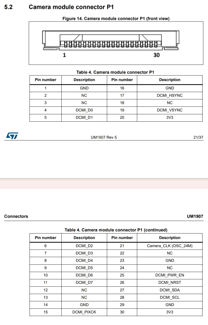

What type of camera should i use with STM32F746G Discovery board?
Hi ST Team,
Please suggest an camera part number which i can easily interface with the 32F746GDISCOVERY Board.
Kindly share the complete details.

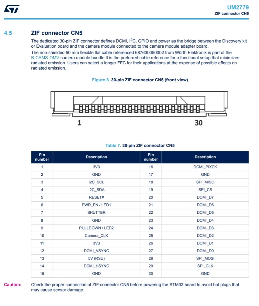

Hello again @Tajwar.Chandel
You can connect the board to the camera module using the  1 × 30 pin ZIF connector of each one of them.
For the camera module :
For the board :
for more details, refer to the UM1907 and the UM2779.

Hello @Tajwar.Chandel
You can use the B-CAMS-OMV camera module that is compatible with the STM32F4DIS-CAM camera module, so you can connect it to your STM32F746 Discovery board. The drivers of the B-CAMS-OMV can be found in the AI vision function pack.
