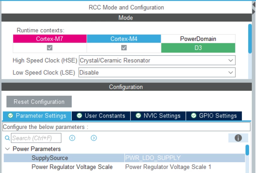

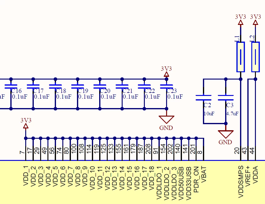

I am using custom designed board having STM32H745BIT6 and 25MHz external crystal with LDO and SMPS pins connected as seen in attached snippet.
I have created, compiled new STM32 project using CubeIDE and CubeMX software for LED blinking.
Attached .IOC file for same as well.
Mainly I don't know about which supply source to select in POWER parameters under RCC section as per my custom board pin connection.

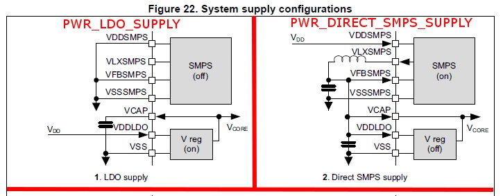

Hello @NDham.1​ ,
Below is diagram from reference manual showing different hardware configurations for power supply:
0693W00000WK6e5QAD.pngSo, you can choose the "PWR_LDO_SUPPLY" as Supply source:
Foued.
