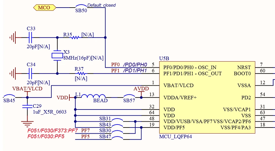

What load capacitance should be soldered for an 8MHz crystal for an STM32F446RE Nucleo board?

  • 8MHz ±10ppm Crystal 18pF 80 Ohms HC-49/US
https://www.digikey.com/product-detail/en/txc-corporation/9B-8.000MEEJ-B/887-1233-ND/2207653
Form the product's image, I noticed X3 (8MHz crystal) is not populated.
I want to solder the above crystal and this has a load capacitance of 18pF.
I noticed the term "stray capacitance" of the printed circuit board and connections.
For the case when connecting a 8MHz crystal to the STM32F446RE Nucleo board/custom PCB that uses STM32F446RE,
  • how can I measure this stray capacitance?
  • what is the approximate "stray capcitance" of the STM32F446RE Nucleo board?
  • since the crystal's characteristic has a load capacitance of 18pF, what value of capacitor and resistor should be installed at C33, C34, R35, R37?
