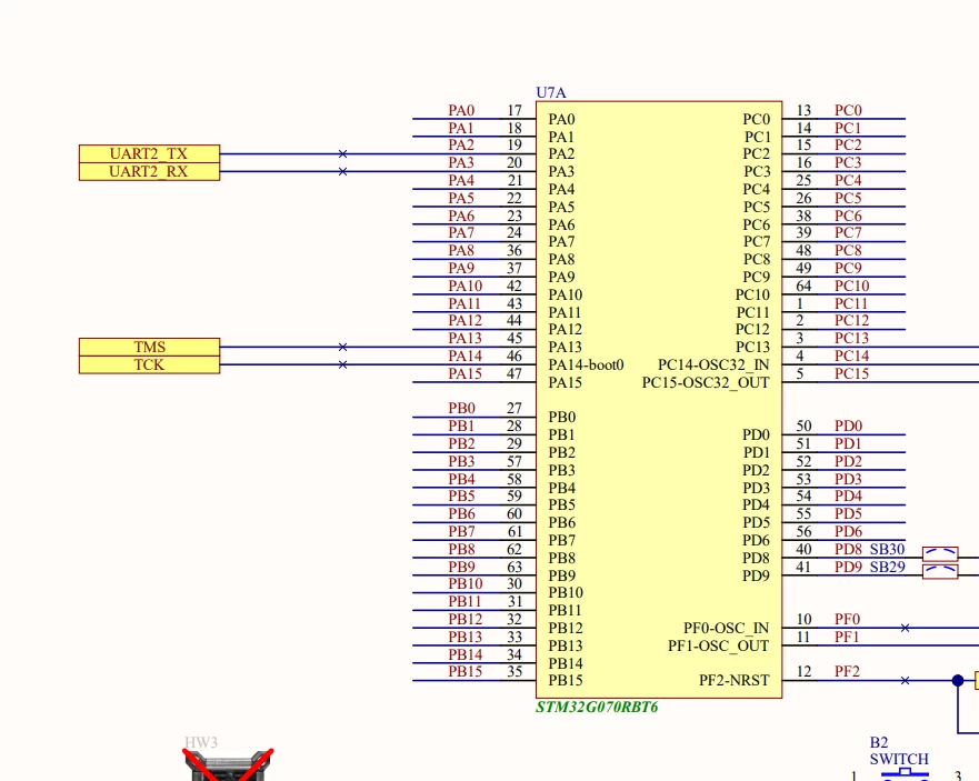

what is U2A/U7A?
0693W00000WKAKTQA5.pngwhat is U2A i see in top of the schematics?
What is the diffrent between U2A and U7A?
thanks
1 reply
Tesla DeLorean
Guru
December 4, 2022
It is where a component is broken into multiple sub-symbols for clarity. Typically where part has many pins, or contains multiple instances.
ie U2 has U2A, U2B, etc​
