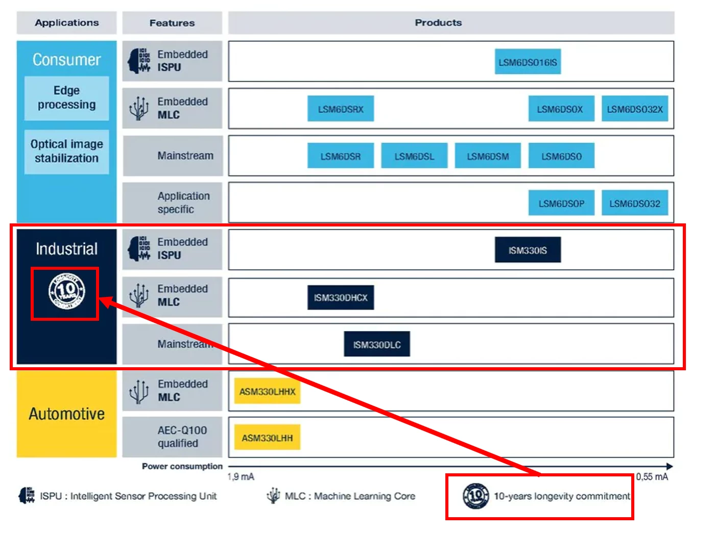

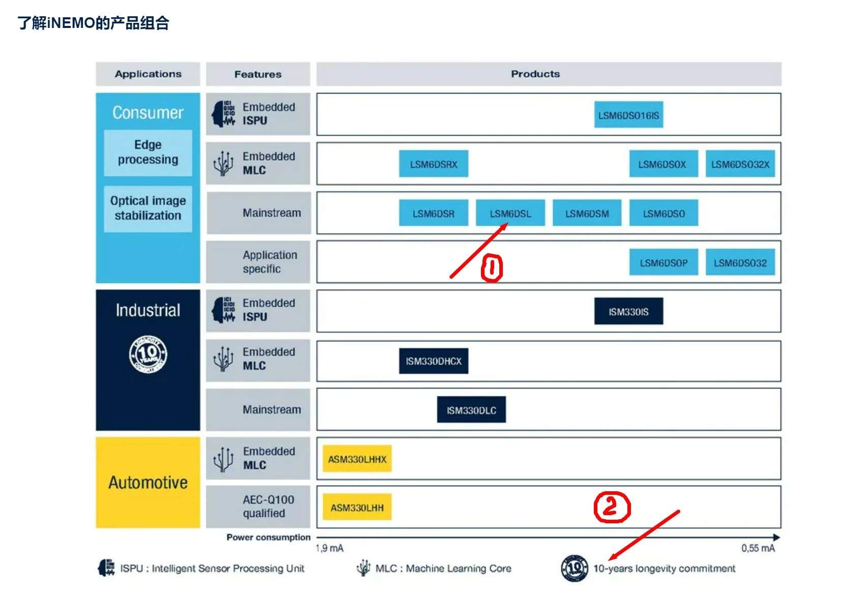

Is the life cycle of the part LSM6DSL similar to STM32F103CBT6?
Simon.T
January 30, 2023
Following this table :Inertial Measurement Units (IMU) - iNEMO inertial sensors and modules - STMicroelectronics. It seems that this LSM6DSL is no part of the 10 years commitment.
However you are un the MCU community forum so I have not so much information. If you want more information, please contact the customer support dedicated to the LSM6DSL.
xwang.6
xwang.6Author
January 30, 2023
xwang.6
xwang.6Author
January 30, 2023
LSM6DSL is also a 10-year commitment, according to its website
Simon.T
January 30, 2023
I think you are misreading the table. The 10-years description below is a legend and not for the whole table. So following this table only industrial product has the 10-years commitment.
xwang.6
xwang.6Author
January 30, 2023
You are right. Thank you very much!
