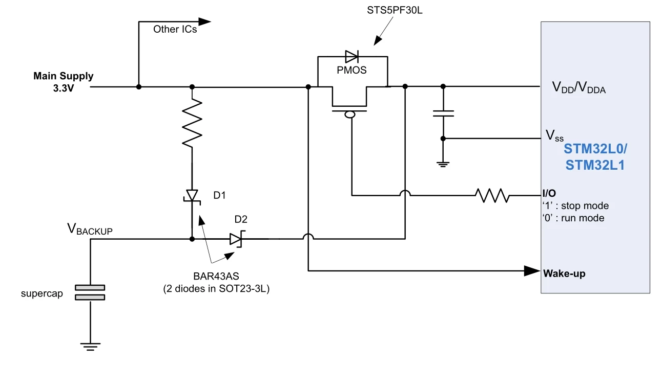

What is the purpose of the PMOS switch for VBAT-SYSTEM STM32L0x1 see AN4718
0693W00000Y85kLQAR.jpgAN4718 "How to design a V BAT system based on
STM32L0/L1 ..."
Case 1b, it is stated, quote:
"V DD /V DDA can also be switched to V BACKUP when STM32L0/STM32L1 MCU goes into STOP mode, to allow user to remove main supply in very safe way."
End quote.
Question: What does that mean "very safe" ?
What is the exact purpose of that PMOS switch ?
Is is to prevent the supercap current going to a battery pin ?
What is unsafe if not used ?

OK, the remark "very safe" is perhaps a bit exaggerated, but it means that in the event of a main supply failure, no current flows from the backup supply into the main supply.
The PMOS allows for low-impedance and thus low-loss switching of the main supply. Since Schottky diodes have quite large reverse currents, it makes no sense to replace the PMOS with a Schottky.

I see. The main supply might be tied to ground, for instance, if broken, and that would shourtcut the supercap.
Thank you very much.
