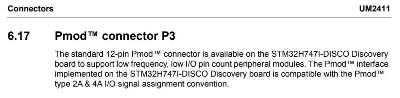

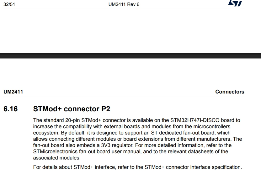

Hi All,
What is the pin pitch of each connector on STM32H747I-DISCO kit bellow. Pin pitch means the distance measured from the center of one pin to the center of the next pin.
・STMod+ connector
・Pmod connector
・ARDUINO connector
Thanks in advance.

Mike_STBest answer
May 28, 2025 8:17 AM UTC
・STMod+ connector => 2mm
・Pmod connector => 2.54mm
・ARDUINO connector => 2.54mm for the shortest distance. But the 4 connectors implementation is exotic. Please check the CAD files here:

Andrew Neil
May 28, 2025 8:34 AM UTC
@Mike_ST The UM refers to these as "standard" connectors. It would be helpful if it gave links to the specifications.
