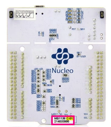

What is the diffrence between the schematics in the CAD RESOURCES?
I am using stm32 G070RB board, and i want to look on the board schematic.
However , there are 3 schematics.
They look the same, can somebody can tell me which one is most suitable?

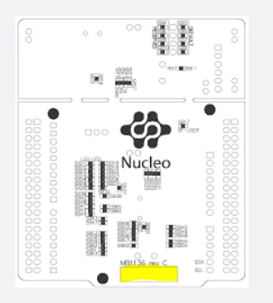

Hello @YShko.1​,
Are you using Nucleo-G070RB or Nucleo-F070RB board?
If you use the Nucleo-G070RB board, you can find one schematic: MB1360-G070RB-C02 Board schematic.
If you use Nucleo-F070RB board, you find three schematics: MB1136-DEFAULT-C03 Board schematic, MB1136-DEFAULT-C04 Board schematic and MB1136-DEFAULT-C05 Board schematic.
So, the C03, C04 and C05 refer to board revision.
To choose the suitable schematic, you need to know the revision board you have.
This revision is marked on the board as shown in the below figure.
0693W00000WLKTrQAP.pngYou can find the difference between the three schematics in the UM1724 and precisely in 7.2 Board revision history.

YShko.1
YShko.1Author
December 20, 2022
Hey @KDJEM.1​  Thank You very much on your detailed answer. However i was mistaken , The name of The board is F030R8!
Can you please tell me how to know the revision?
KDJEM.1
KDJEM.1Best answer
December 20, 2022
Hi @YShko.1​,
The revision is marked on your board as shown in the below figure :
0693W00000WLPEwQAP.pngFor example, this board revision is C01.
