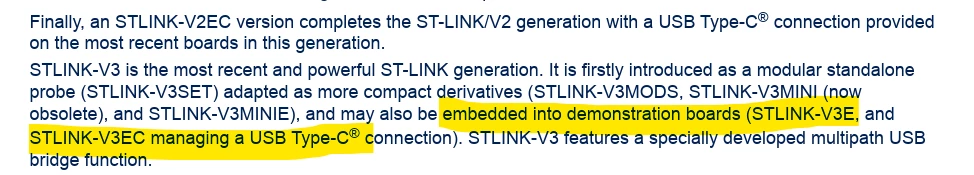

TN1235 implies the differences between V3E and V3EC by describing the introduction of type C USB connectors since STLINK/V2. See the brief history on page 2.
It seems to be that V3E is the embedded version of STLINK-V3SET and V3EC is the embedded version supporting USB-C

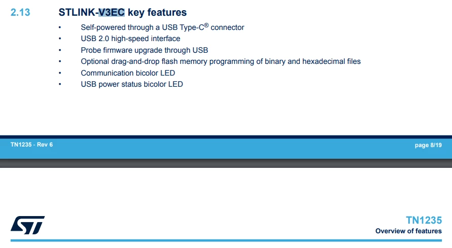

https://www.st.com/resource/en/technical_note/tn1235-overview-of-stlink-derivatives-stmicroelectronics.pdf#page=8
via: https://www.st.com/en/development-tools/stlink-v3set.html#documentation
EDIT:
Sorry, misread the OP: Indeed, V3E is mentioned many times in that TN1235 - but it is never explained.
There is nothing that describes what differs between V3E and V3EC
So it does - well spotted!

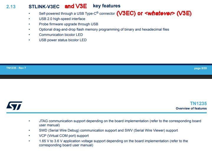

@STTwo-32 but this is very well hidden - easy to miss - as this thread shows!
The document should be clarified; eg
and are there any other differences?
