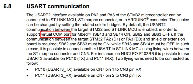

What do Linux (and Mac?) people call a "Virtual COM Port" ?
So a bit off-topic, but arose in the context of STM32 Nucleo boards:
https://community.st.com/t5/stm32-mcus-products/communication-between-nucleo-f411re-and-raspberry-pi-using-st/m-p/721571
"Virtual COM Port" is a Windows-centric term - referring to the COMx: device names that Windows assigns to Async Serial interfaces.
Linux doesn't have COMx: devices  - instead, it has /dev/ttyXXX
I know nothing about Mac.
So what do Linux people call a "Virtual COM Port" ?
Do they just say "Virtual COM Port" - ignoring the Windows connotation, and knowing that it really means a /dev/tty device?
Or do they have another recognised name for the concept?

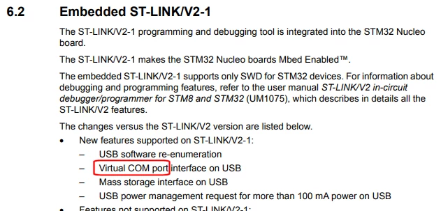

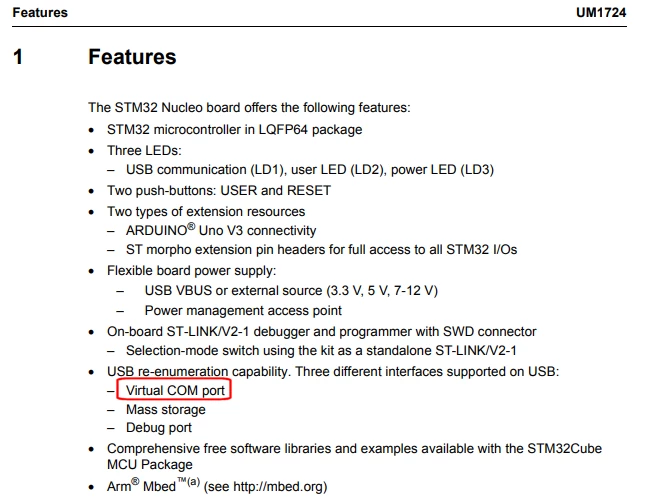

Yes, but when speaking about it, what word(s) do they use?
The ST documentation uses "Virtual COM Port" pretty much exclusively, I think - so Windows-centric:
But what would a die-hard Linux person write there?
