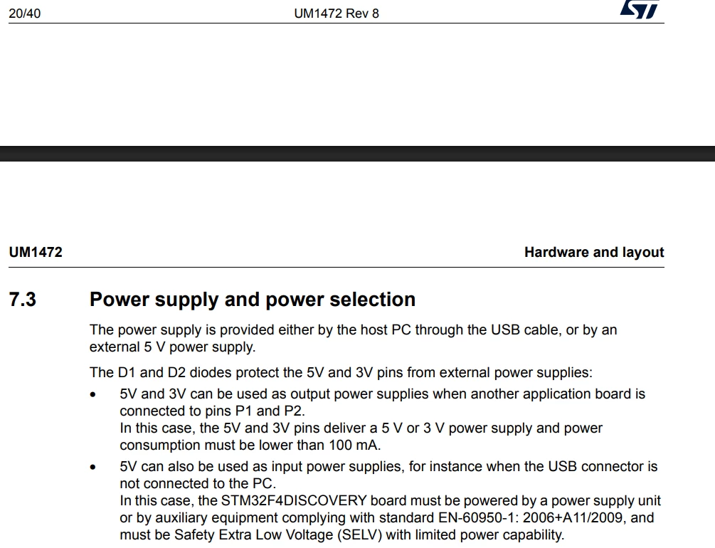

Hello @cockatoo
You need to configure your board to be powered from an external power supply
you can refer to the section 7.4 of this user manual if you have the LQFP144 package
BR

Andrew Neil
Andrew NeilBest answer
Jan 28, 2026 11:00 AM UTC
As @Gyessine said, the User Manual for the board will tell you what its power input options are, and the specifications for each option.
So you just need a power source which meets those specifications.

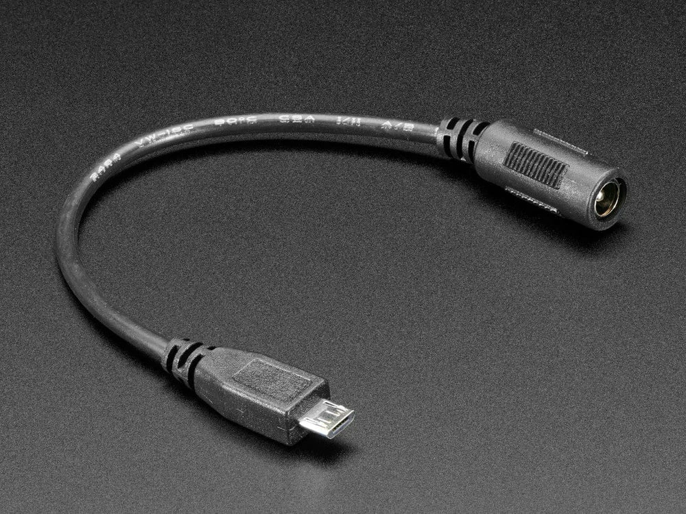

You could even power the board via the ST-Link USB connection using a USB power supply or power bank.
eg, via a lead like this:
USB specified 5V power - so you just need a 5V power supply.
One thing to note about USB power banks is that larger ones tend to have a minimum current - below that, they just switch themselves off, thinking nothing is connected.
@cockatoo wrote:
The board I use is stm32f407g-disc1, and the datasheet (DS8626_STM32F40xxx.book) says...
That's the datasheet for the STM32 chip itself - not the board.
You need to read the User Manual for the Board:
